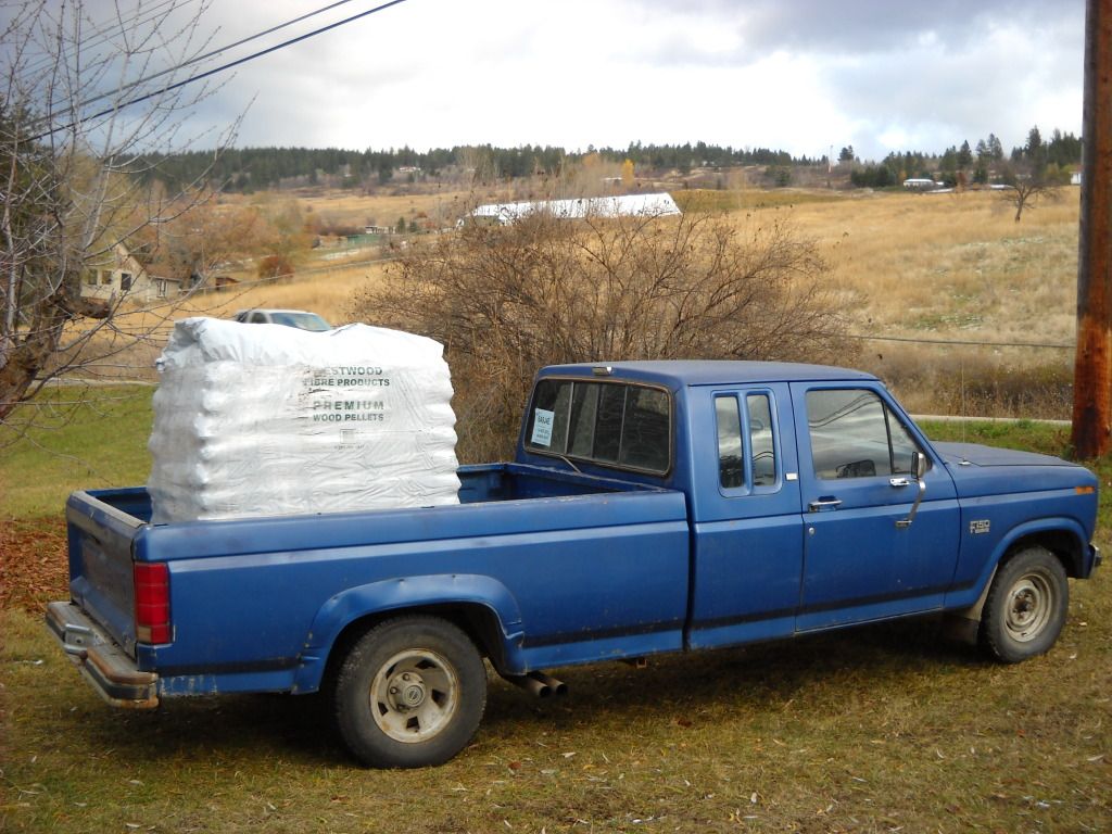

Every fall I put a one day permit on my 85 F-150 and haul four tons of wood pellets for my pellet stove and a load of garbage to the dump. Three years ago after the dump run I went to get wood pellets, about 14 mi. round trip, and they would only put 1/2 a ton on my truck at once. This meant 8 trips, a lot of extra work and a lot more cost. So I decided to get the M-350 on the road then I can haul 2 tons at once. Good excuse anyway, but it means I had to put Old Ugly on the shelf for awhile. I do a bit on it once in awhile. This last fall a place about a mile from me started selling pellets and they will put a full ton on, I don't even need to go on the main hi-way.
Here's a pic of the 85 with one ton of pellets, handles it quite well.

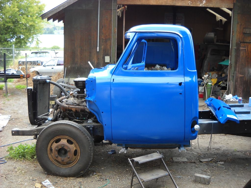

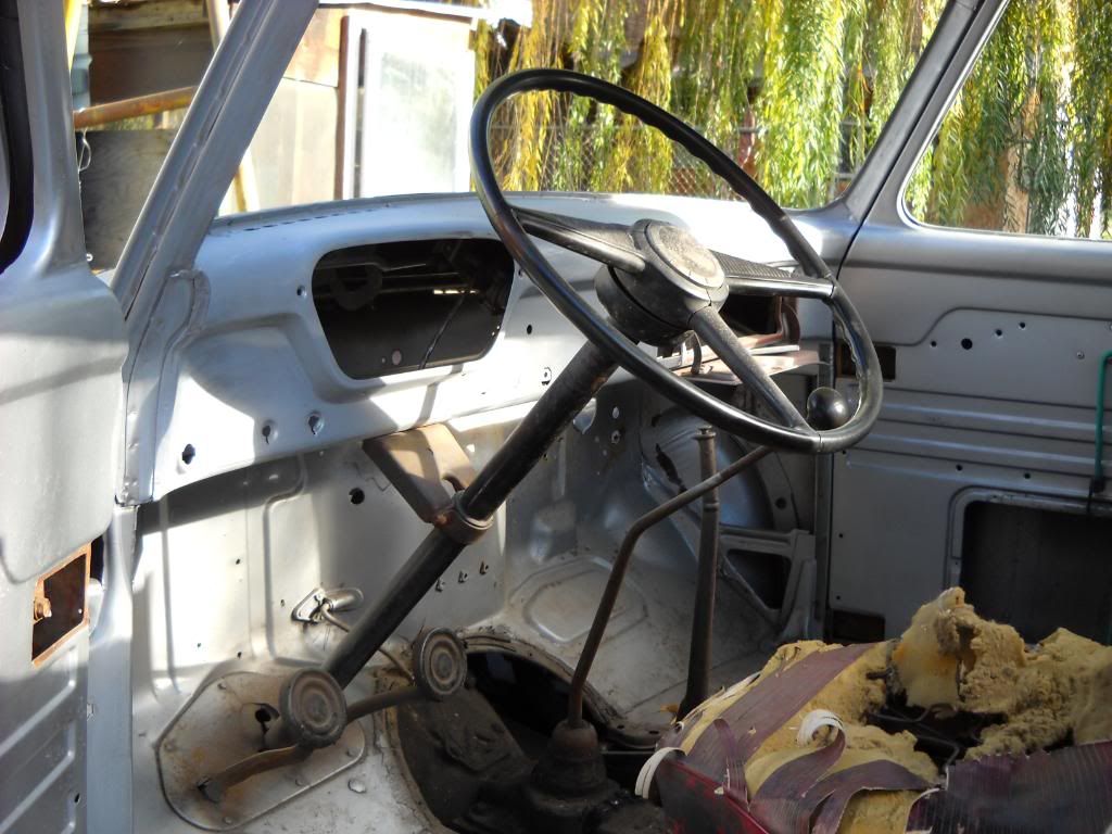

So now that my wheel and brake issues were taken care of I moved on to body work and paint on the M-350. Painted the inside of the cab and removed the steering column, painted it, added the signal switch from a 55, found my best steering wheel, repaired and painted it and started to put things back together. here are before and after pics.
Old Jan 27, 2012 | 11:25 PM
old ugly's Avatar
old ugly
Joined: Sep 2010
Posts: 374
Pics seem to big so run out of room. Here's the after pic.
Then painted the outside.
