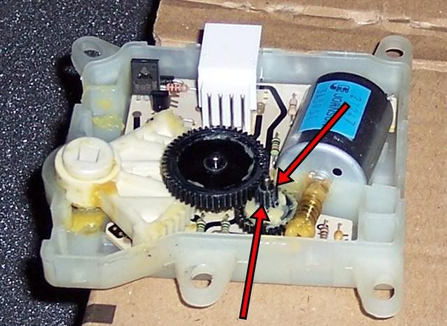

The shaft will still turn. The problem is with a damaged gear. This is mine with 3 teeth broken off:

This is great news. I didnt try to fix it yet because taking out the dash is a scary thing for me and I didnt want to spend $89 on the actuator if i wasnt sure it was shot, and giving the ford garage $1500 to $2000 is out of the question

No problem. If you go by my write-up you wont have to take out the dash, just the console. It is a step by step with pictures of every step. Hey if I can do it anyone can!!
