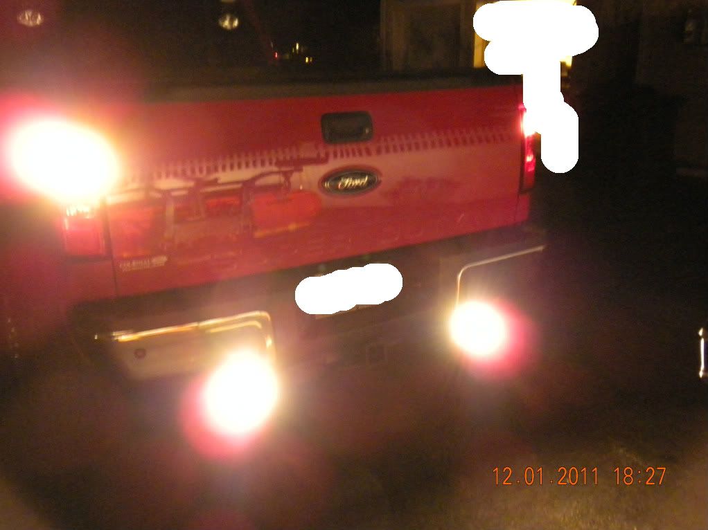

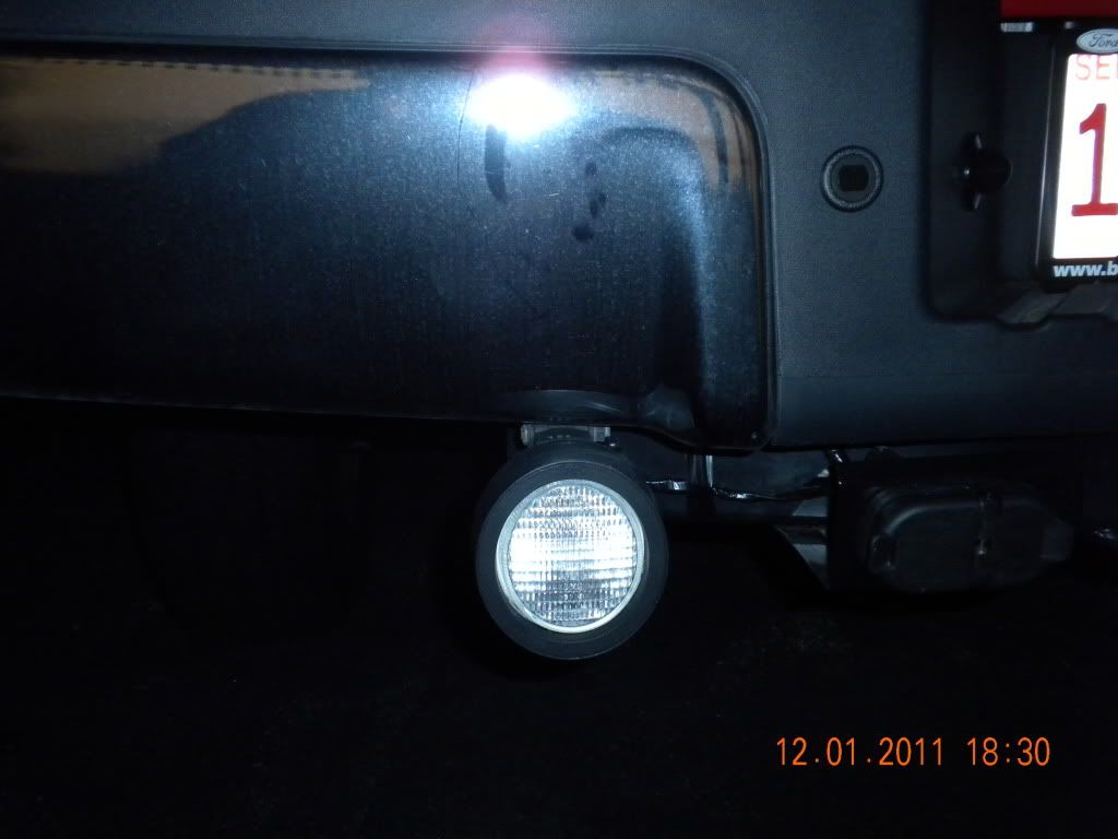

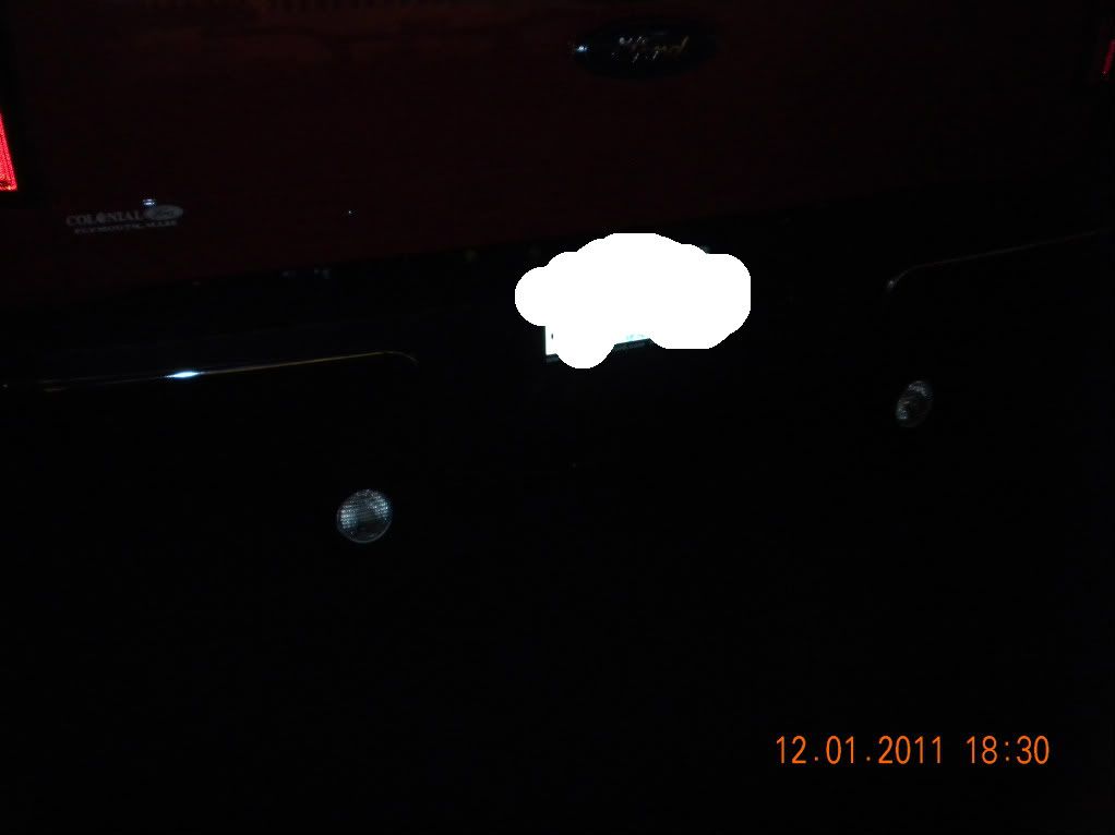

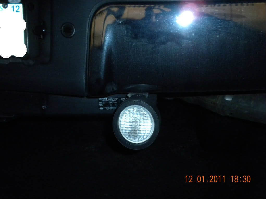

I'll post some pics of mine, I'm looking for the Hella Part # or catalogue info right now, in the mean time you might look at this from the ford truck builders, just the note at the bottom of the bulletin about adding additional back up lights. I have mine tied into the trailer wiring, which I believe is how the white knights work as well, I had one of those a while back, but went with separate lights now on my new truck.
article here---> https://www.fleet.ford.com/truckbbas.../Q-190R3v2.pdf
That last picture is just to show the light that they throw when they're on..

Here's a really good price on the lights I used, I think I paid over 50 bucks a piece for them when I bought 'em
Hella Mega Beam Halogen Work Lamp 996134197 - Hella Parts & Accessories
Page 47 in this catalog from hella
http://www.myhellalights.com/pdf/201...Catalog_sm.pdf
They are a flood style and super bright, They have to hang verticle though for the flood pattern to be right, i had them mounted in a horizontal manner and realized the light pattern was all F'd up that way.
