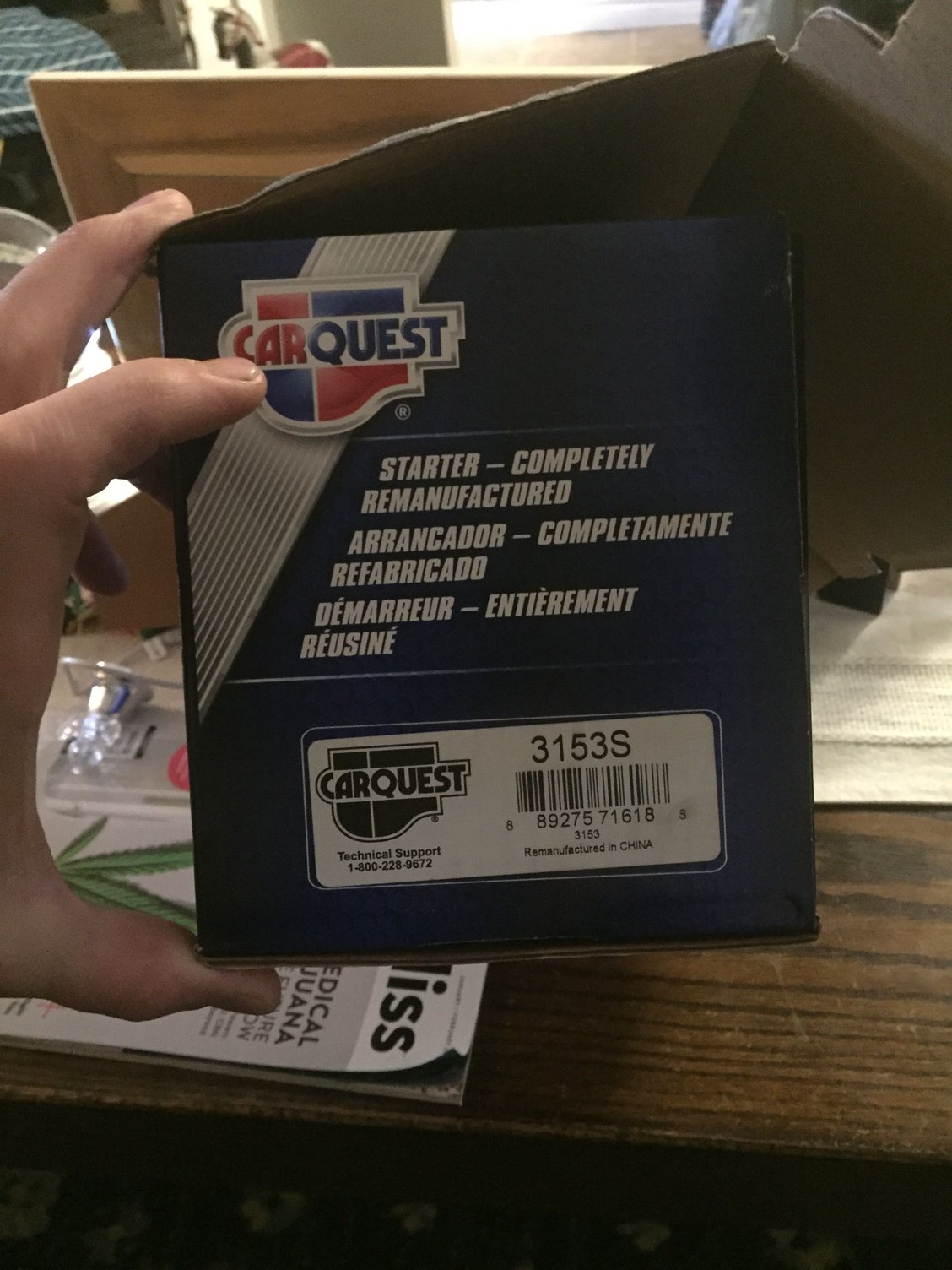

Starter grinding c6 351w
I had the same problem I bought a 87 F150 that nobody could start I got a C6 flex plate and found a starter from a 1978 E150 part number on box 3153S
