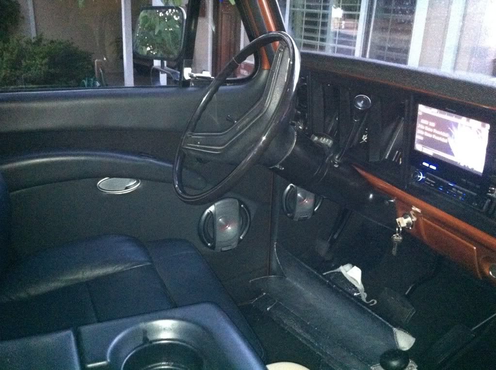

I wouldnt buy the headliner kit from LMC with the speakers in it, having sound blast right in your face isnt going to sound good.And honestly a lot of the stuff LMC makes is crap. Also I wouldnt put any speakers in the dash either. The only thing I have in my dash are tweaters for the speakers in my kickpanels. What I would do is stick with the 6 1/2" speakers in your doors, which is plenty loud enough in a small cab even without an amp. And if you want more sound add a couple 5 1/4" speakers in the kickpanels, but that will require cutting or add a couple of 6x9 in an enclosure behind the seat, these will also give you some bass. As for behind the seat if you want even more bass then buy a thin mount sub and build an enclosure, but then your going to need an amp. Just make sure you do a little research before you decide to buy cheap speakers from LMC. I usually buy from sonicelectronix.com, they have good deals and carry quality stuff. The thing with audio is you get what you pay for, so if you only want to spend $50 on a set of speakers then they are going to sound like crap. I prefer Alpine speakers and Kicker subs. Depending on what models you get they can be pricey, but its worth it.
Im currently redoing this interior, but heres my setup. All the speakers are alpine components with a 400 watt amp and a 10" kicker L7 with a 500 watt amp.I have a pioneer head unit. I spent a lot of money on the audio for my truck, but Its worth it for me. It doesnt have to be this powerful of a system, but just make sure you use quality equipment that will last. Also when you install speakers in you doors make sure you buy foam baffles for them, Its a foam cup that your speakers sit into and it keeps the elements away from your speakers. Theyre pretty cheap only $10 a pair.
