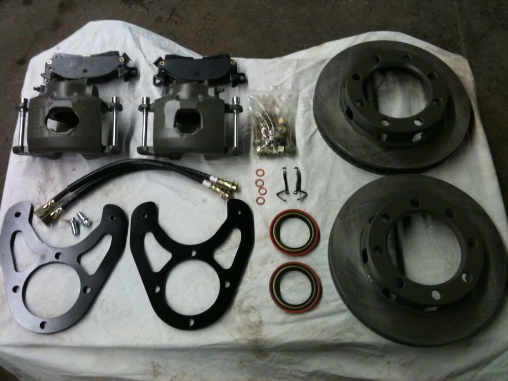

I bought one of the eBay conversion kits. All new parts and it came with everything I needed other than brake fluid. I think it was in the $300 range?
