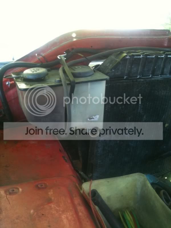

rad fluid pressure
it seems on some occasions the fluid flows out of the rad overflow tube.
what would cause this to happen. it seems to be happenning a lot lately.
my first thought is a bad head gasket. oil is clean as can be.
dont know how long this has been happenning. i have only had the truck a
few weeks. this has been the farthest i have drove the truck in a while,
besides the drive from NY to VA. it needs to be topped off fairly often.
since i put the over flow tank on it kind of helped keep the fluid better if
that makes sense.
anything i can look for or test ?
Thanks.
Hmmmm.... I don't think it's a cap issue.
Only fill the recovery tank to be half-full. Cold coolant will expand when heated and get pushed out into the tank to up the half-empty volume. It'll then be drawn back into the radiator after it has cooled. After a while, it will find its natural level.

Is the truck overheating at all? This happens when the cooling system pressure exceeds that of the radiator cap. It's normal for it to happen every once in a while, but with a good 16-psi cap and an engine running at 195 F, it shouldn't happen all too often.

lots of good info here guys thanks for your help.
i have a 180 stat. yes i probably over filled it a little. i topped it off
right up to the cap. at one point i let it go for a week then it took almost a gallon
to fill it back up. it never runs hot only when it gets low. even then it stays cool
till i get to a stop light and sit before the gauge starts to move. If fluid level is normal,
the gauge does not move no matter what. im sure i need a new rad cap. this one looks
like the original. i did put in a 80's or 90's rad overflow tank. oil looks good. hate to know
if it is going out the exhaust. dont know what to do.

Pressure test the cap and system. If the system has a leak other than just the cap the pressure test will show where it's at.
Old Oct 10, 2011 | 01:23 AM
bdevr's Avatar
bdevr
Joined: Jan 2011
Posts: 110
In your picture there is no fan shroud. This could easily be the cause of the temp rising when the truck is not moving.
