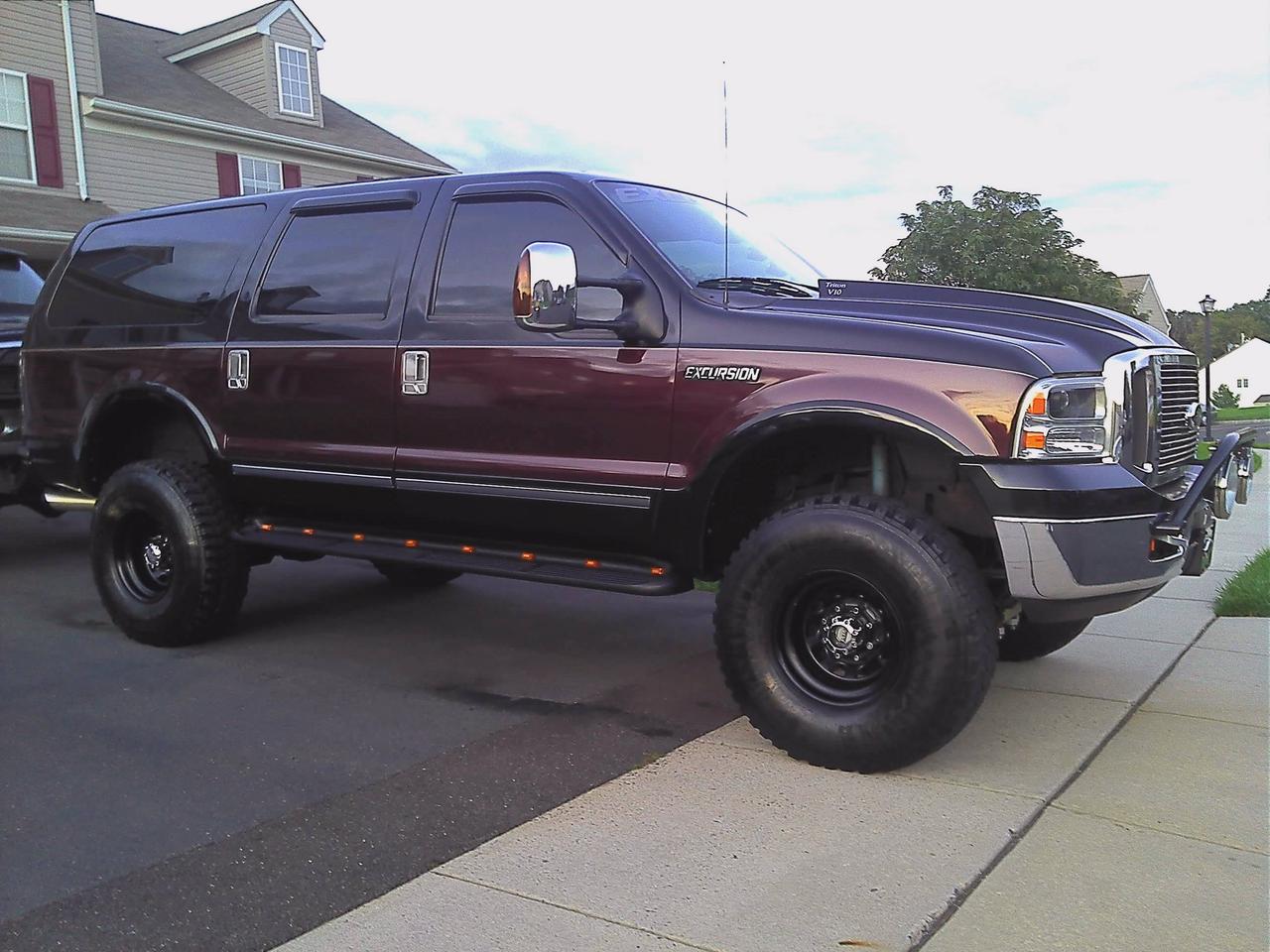

I can tell you this, 8" lift is pretty damn big. And I have 4" lift and 37" tires.
Attachment 42004
