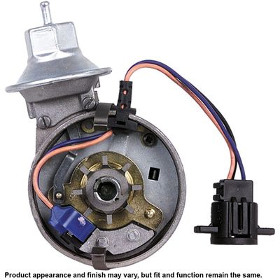

Does this look right to y'all? In case you cant tell, the hex part is recessed about a half inch.
But mine looked more like this:
I have a feeling I'll be calling Autozone later

Did you do a side by side comparison to make sure the dists. were same length? hex openings the same? If seen some 1/4" and 5/16" drive. Pin in drive gear in dist?
The looked the same, but I didnt pay attention to the bottom of the shaft. I took the truck up and down the street before I saw the lack of oil pressure and heard what sounded like a rattle can. I didnt fark anything up, did I?

'zone strikes again. Did you get part no. 30-2893?
