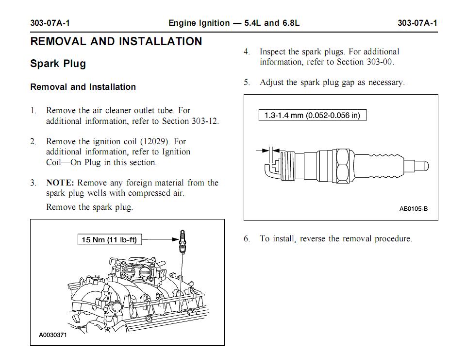

Here's why I settled on 11 ft lbs. By the way, I did spot check one plug on each side after about 1000 miles to make sure they were still tight and they were.

Agreed 11lbs would be great however a few things to keep in mind.
11lbs w/o lube might not seat them correct as friction ( metal threads vs. aluminum heads )
11lbs w/ lube will be a lot more in the ball park.
I watched a great review of this in Horsepower TV the other day. They were showing different thread lubes vs. the torque values achieved. Highly recommend checking it out.

If I can find the Ford recommendation I'll try and scan and post, but no fuel rails don't have to be removed. I used brake cleaner to let soak and work back and forth, there's a great thread on here somewhere and I did 11ft lbs(Actually just looked back I went 120 inch pounds, I used a 3/8" torque ratchet cause it was easier to maneuver so 12 ft lbs) with anti seize no problems so far been a couple of months, also I only changed one COP the bad one and I used autolite plugs, I have a V-10 took me 10 hrs but that was mostly an excuse to get away from the wife, LOL OH AND MOST IMPORTANT THING A COLD ENGINE!
