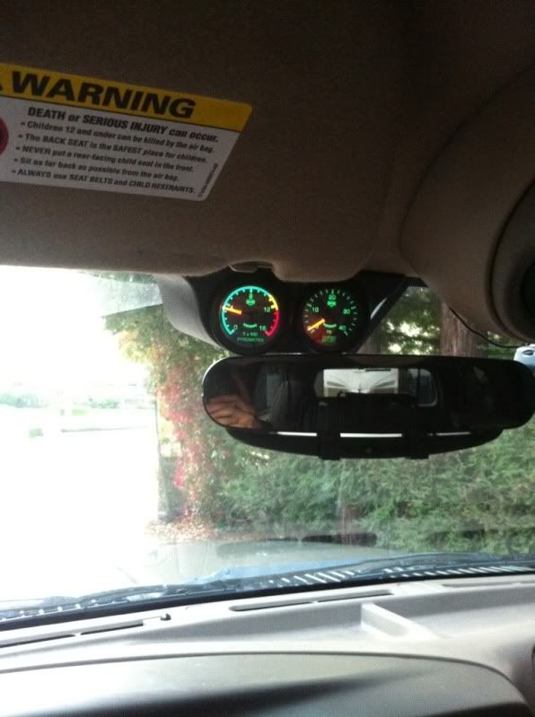

Yep, my overhead console is different. I'll make the gauge pod fit somehow.

Here is mine, still need to paint it tho.
