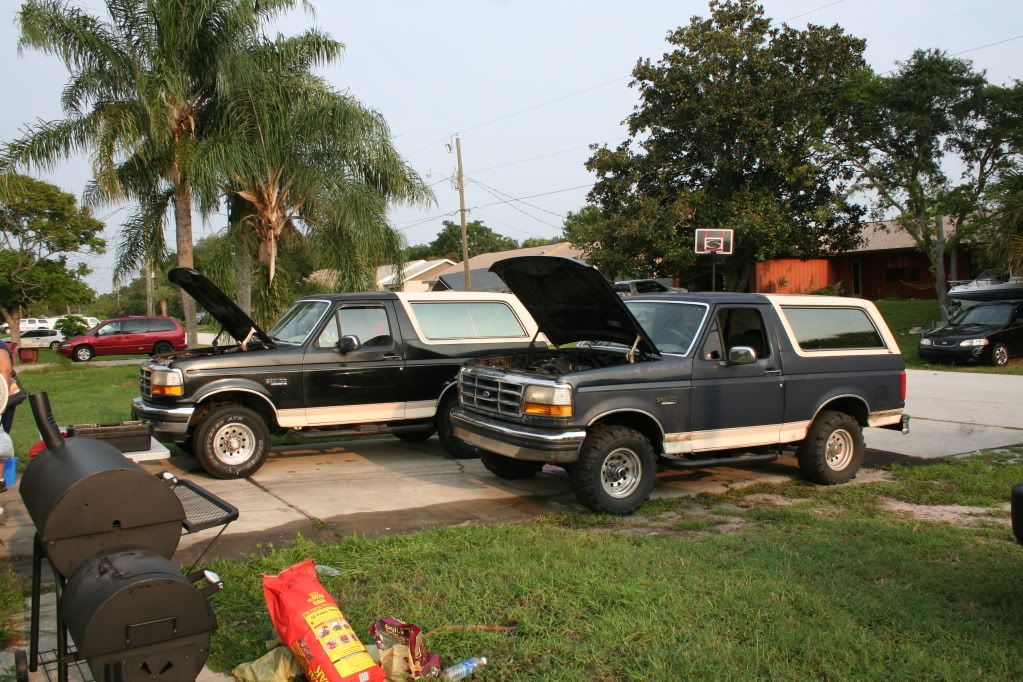

Hey Guys,
Sorry I haven't updated this in awhile. Turns out i took a break from the project for a bit. When I got back to it, I just happened to be surfing craigslist when I found another bronco that was in incredible shape but had a blown motor. (only 130k on it) So, to make a longer story short, I purchased another bronco and swapped the motor from the old one into this one. (motor has a rebuilt tag on it *bonus*!) All together I have about 2k invested and now I have a running truck that is just about perfect condition with no mechanical issues at all and a great parts truck including an e4od as well as a 351 that I plan on rebuilding and keeping around.
Here is the new one
Here is the two side by side
Engine going in
putting new tires on tonight, replacing the alternator and I will be on the road in a day or two. Thanks for everything guys and will be on here alot more now i am sure!!
