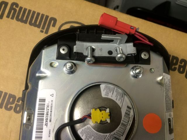

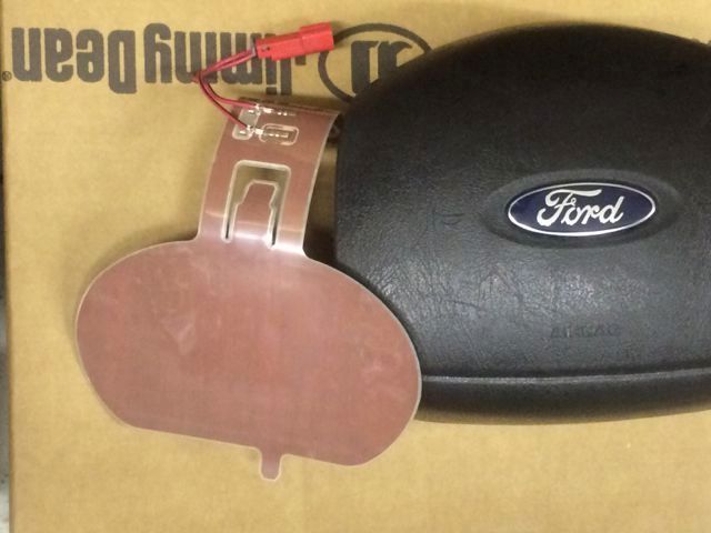

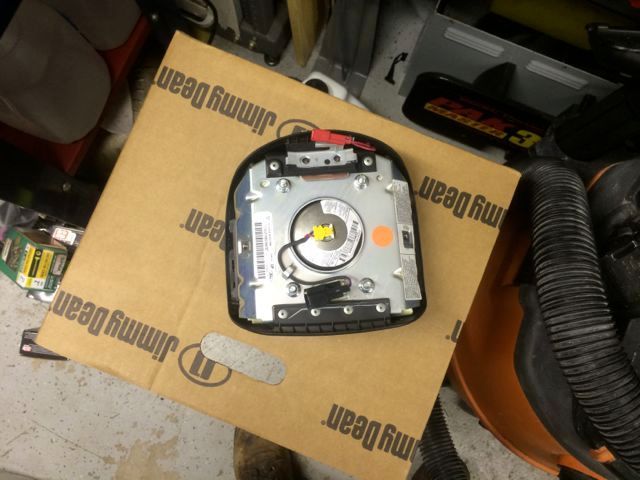

The switch in my 2006 is a sealed unit that can be removed the same way.
You can even buy the switch from Ford. But it's not cheap. It's almost the
same price of a new airbag.
Have a look at the 2006 switch.
With the screws out the switch comes right out and there is no talc on the airbag.
The switch is heat sealed on the edges with no way to get into it.
Sean <BR>
6.0L Tech Folder

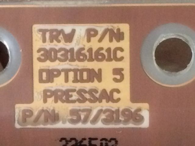

Yahiko, thanks for the pictures, my 1998 version looks the same, same pressure switch manufacturer too.

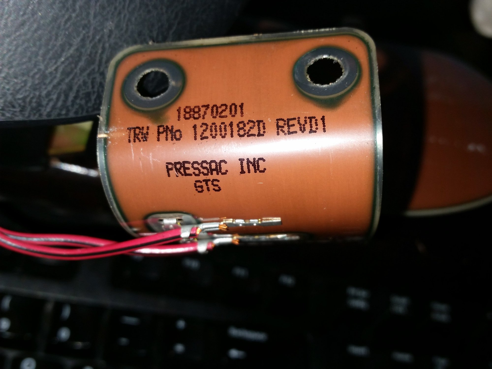

pictures of my pressure switch. there are horizontal ridges, from the backside of the rubber horn pad (part you hit). Also mine has dimples on it whereas Yahiko's does not (mine '98, his newer).
I wonder if the rubber ridges on the backside of the rubber horn pad are getting hung up on the pressure switch in these ridge depressions, and as heat/humidity causes things to expand, it's actuating the pressure switch?
