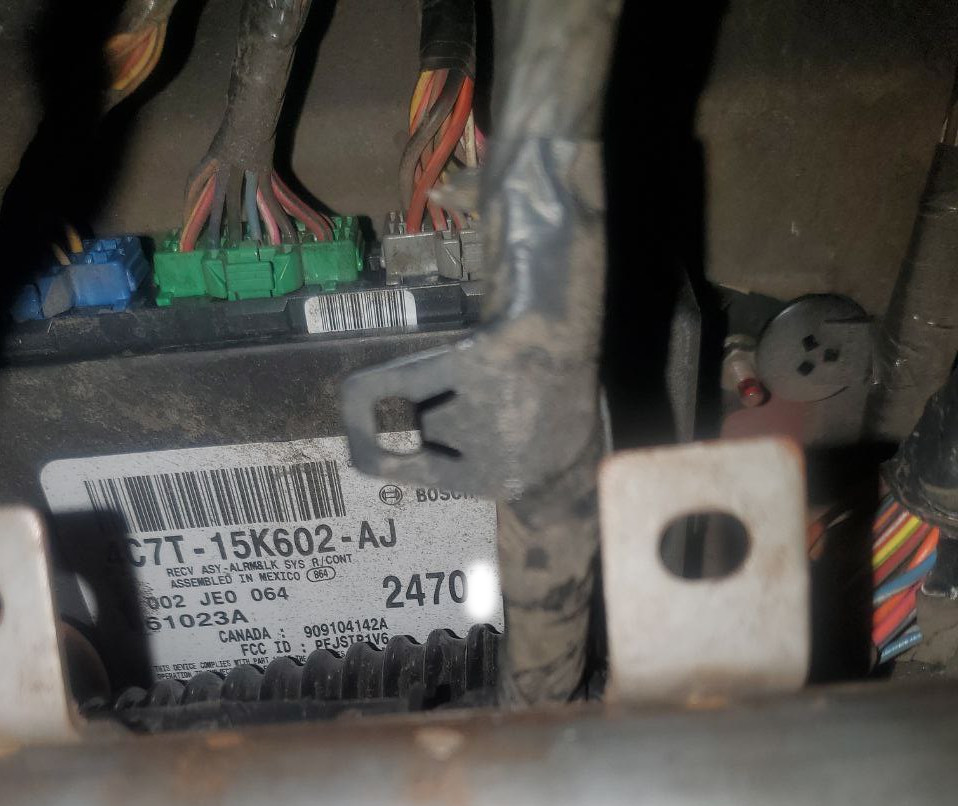

the door code is printed on the VSM, under the dash, behind the radio downwards and to the left a bit.
here is a pix of my door code, useless to you guys, unless you want to open up my truck

I just broke down and used the video in Post #69 to find the label. That video is for a 2005, but I can confirm that it is the same for a 2004 model year as well. I had tried this before, but my old eyes wouldn't let me see that close and the contortions made be angry, so I quit. This time I borrowed my wife's readers, put them over my bi-focal glasses, and tried again. It definatley takes some body contortion to get your head down there, a good flashlight, a small stick to prop up the insulation, an inspection mirror and the ability to read numbers backwards.
