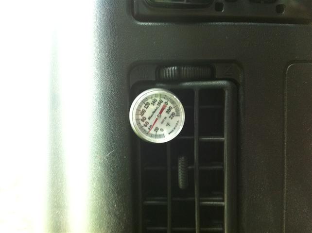

Originally Posted by bama29fan
with the gun at the right operating temp it was reading in the low 40's upper 30's at ambient temps about 85.
those sound closer to reality, but if you want an accurate reading of your vent temps, you should get a snap-on or robinair thermometer to stick in the middle vent.
just think of it as adding another gauge....

Mine is blue point. Does that count?
Anyway, empiretc is right on the money. Get a thermometer to get accurate. We have those Temp guns at work and they have a big variance. We bought three identical Fluke guns and none of them read the same. One was off by 15 degrees. I was always taught if your cooling more than 25 degrees than the outside temp then your ahead of the game.
79 Degrees when that picture was taken @ 62% humidity
I got out of the truck and my glasses fogged up.
