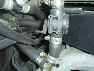

The ball valve i used is a Watts brand made of brass 1/2 ".....used in plumbing applications. I also purchased a 4" nipple threaded on both ends(Brass)and cut it in half. Srewed the 2" threaded ends into the ball valve ( I teflon taped the threads). Cut heator core hose up by the firewall. Push the heater core hose over the brass pipe up to the base of the ball valve (very tight fit....it will go). Secure with a couple hose clamps. Maybe 15 dollars for everything....and 10mins of your time.

Do you have pics of your setup? 

Trying to post a pic.....

I believe its just a 1/2" ball valve with 2" nipples on both ends. Cut the hose supplying water to the heater core, and use clamps to secure. Don't over tighten. The wrench size is 1".
