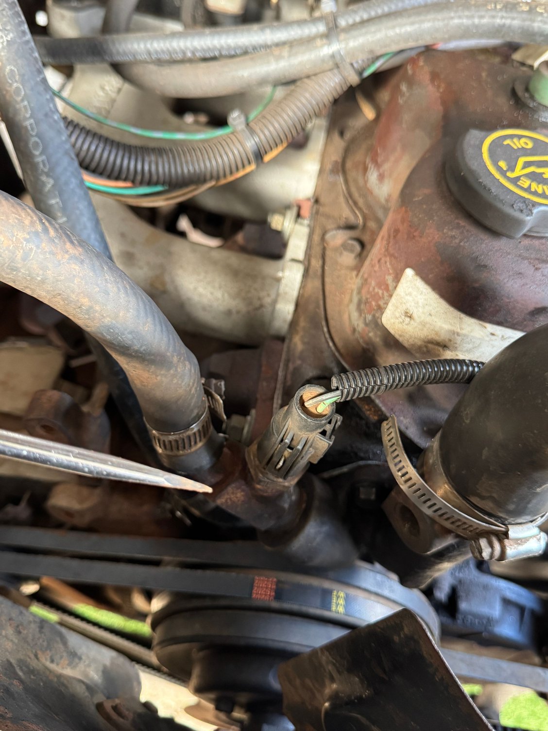

What part is broken got a picture of it?
Dave ----
picture below. I was in the middle of a Heater core bypass that turned into flushing the Mississippi River out of my radiator and block. Got into the thermostat while I was at it and realized my thermostat housing and heater hose outlet was heavily corroded; especially the parts that the radiator hose and heater hose connect too.
After realizing I couldn’t find it the parts I just reinstalled them so I could finish the coolant flush. It’s something I want to replace soon though as I’ll be replacing the water pump. It’s shot. Thanks Dave!
Heater hose outlet and thermostat housing
Heater hose elbow outlet and thermostat housing

Ok so it is just the part the sensor is in and the hose on and I take it the hose part has rusted and is leaking?
Well junk yard as Ford dose not have it and I dont think the parts stores have that part. They do have the stat housing but you have to watch as the hole that fitting screws into is too small on some like from Auto Zone, O'Reilly's had the right one.
Here is what I would look into doing. You can get hose nipples with threads on one end. I would see about cutting the rusted hose off that fitting and see about threading the fitting for the hose nipple.
Only thing to watch out for is how far the nipple threads in that it dose not hit the sensor when the nipple is installed.
If a threaded nipple dose not pan out I would look into using copper fittings. Again cut the rusted part off, thread the fitting to take the copper thread to solder and built it up to take a heater hose.
Paint the copper black or silver and no one will know.
Report back on the fix so others will know what works.
Dave ----
