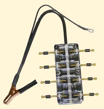

Here is an even better one.
Mastertech Outboard Motor Repair and Marine 8-WIRE SPARK TESTER

Originally Posted by Bear 45/70
YIKES!!! $75 Cool Tool but.... for a electrical idiot like me??

The tester I posted the pic of, is called an Ignition Spark Tester, is made by Lisle, and is usually available at any Auto-Parts store. Those stores, like Napa, usually have a rotisserie stand with Lisle tools hanging in blister packs. The P/N is 50850
Here's a link from Amazon:
Amazon.com: Lisle 50850 Ignition Spark Tester: Automotive
This one is the first one I found in a short Google search (Outboard Spark Testers). There are cheaper ones. The last one I bought was for only 6 cylinders(the big outboards were only 6 cylinder back then, but it was like $20.
