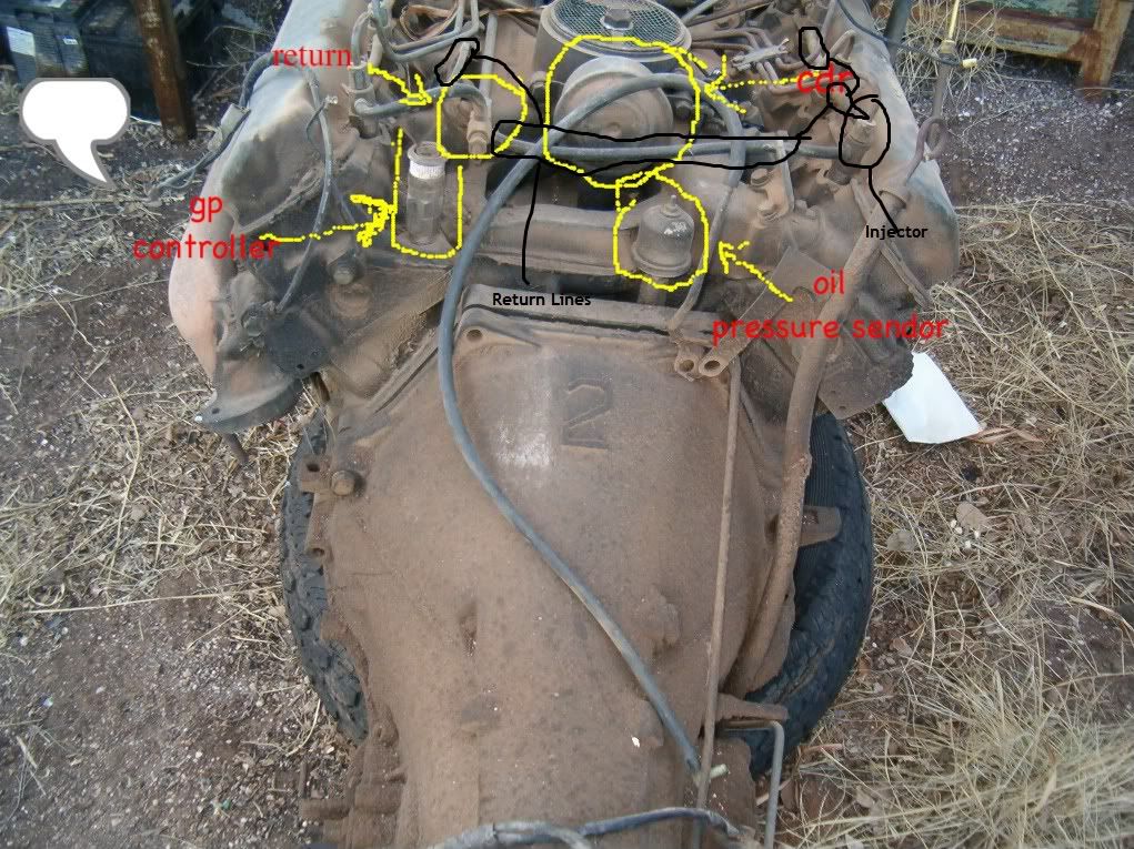

Here you go, I went and labeled the injector return lines, these are what causes air intrusion. And you need to pull the old rubber ones off and replace with a simple return line kit for the engine.
Labeled Parts:
Back:
Front:
New Fuel Line Kit:
Cardone 2K201 - Fuel Injector Installation Kit | O'Reilly Auto Parts - Local Auto Parts Store In Montana.
Pensacola Diesel:
Pensacola Fuel Injection | Worlds #1 Diesel Rebuilder - FORD 6.9L - 7.3L :: INSTALLATION KITS :: 83-89 6.9L/7.3L Injector Installation Kit

Hey bud, having used that kits from pensacola, I don't recommend the it, anything cheap is cheap for a reason. The one from Oreillys don't look bad though.
Amazon.com: Delphi 7135-276 Injector Installation Kit: Automotive
