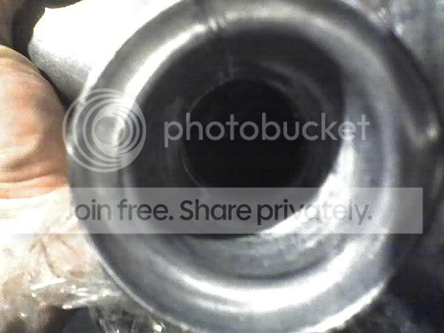

The walker Y pipe is large internally but often the hole in the one pipe where they are welded together is a restriction.
You can take a 1 7/8" hole saw with an extension and open it up.
(these pic's are from Josiah's 300 build thread)
Stock EFI split manifold, individual pipes:
EFI manifolds, Walker Y pipe:
This is a view inside the Y-pipe with the hole cut out where the rear pipe is fishmouthed and welded onto the front one:
