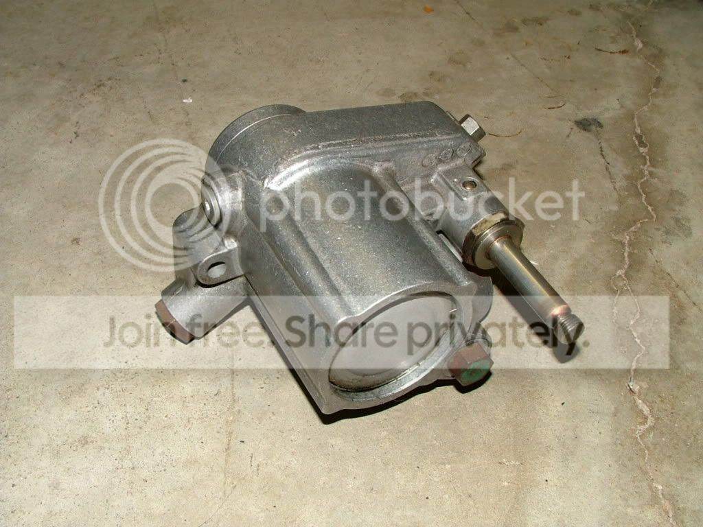

I'm not 100% positive, but the nut you see on the top right above the IPR.
I'm pretty sure thats it.
Is it possible for the oil to be coming out of the big circle of the hpop on the back? I hope I'm making since? Not the plug next to the IPR nor the IPR but to the left on talyn's picture here. That's where I found the oil to be coming from finally. I drove the truck after cleaning the valley again. With towels down in the valley, thanks ROENTGEEP. I found out the oil is coming from up front and from the HPOP. At idle it has a slow drip and at higher speeds/loads I'm sure it squirts out of there. Now the fix? I will replace that plug's oring also but the oil was coming down the passenger side of the back of the HPOP.

William, the blow-off valve is the big 15/16" nut on the top, passanger side if the pump. The one your referring to is what Ford calls the non-serviceable port. Pretty close though.
To the OP, check that non-serviceable port and check the 11/16" nut on the back of the pump, directly in line with the high pressure lines. Just put a wrench on it. If it turns at all, remove it and replace the O ring(-6 boss). Make sure you use a Viton O ring, or you will be doing it again in a few weeks. 99% of the time, it's the rear plug.
