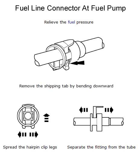

If you want to test your pump on vehicle like suggested by Clint here is how the connection at rear of pump is removed. It is not the typical quick-connect type. Once you get the connector separated you can slide a piece of hose right on the pump's rear fitting.

Thanks for the schematic PSD. I ran a fuel pressure check on my truck today and I am getting 110 at the pump. I had a lot of air in lines and discovered that the fuel retaining clip at the front of the pump was mangled and was letting a good bit of air in the line.
