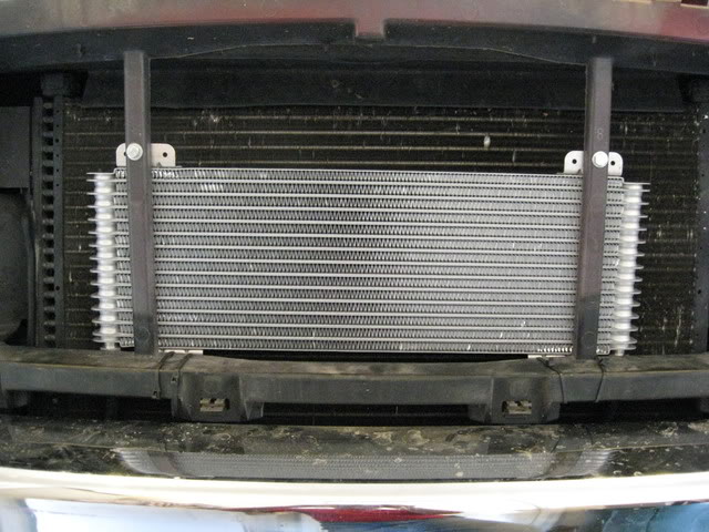

This is how mine is mounted (not my pic, however)and it was described to be done in the dieselsite instructions.
Name:  Trucool (SD mounting location).jpg
I have not seen any info regarding a specific line orientation, so I would guess that it wouldn't make any difference.
Attachment 34081
Mine is mounted down as well I got mine from dieselsite. I never see temps above 125 any time of the year, it is working just fine. I wouldnt worry about air in it
