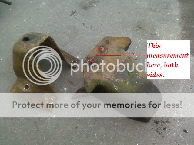

1973 had two types of towers/perches/mounts, the 2wd, and the 4x4. The 2wd rested on top of the crossmember, and required the crossmember to be there for support. The 4x4 mounts went directly to the frame, which had a reinforcement built in. Here's a pic:
never mind the writing, I was using these for a question on the 73-79 forum.
To add, the 2wd crossmember butts up under the top lip of the c channel section of the frame, with the perch bolting in over the top.
