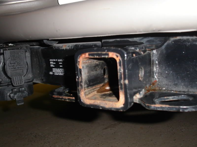

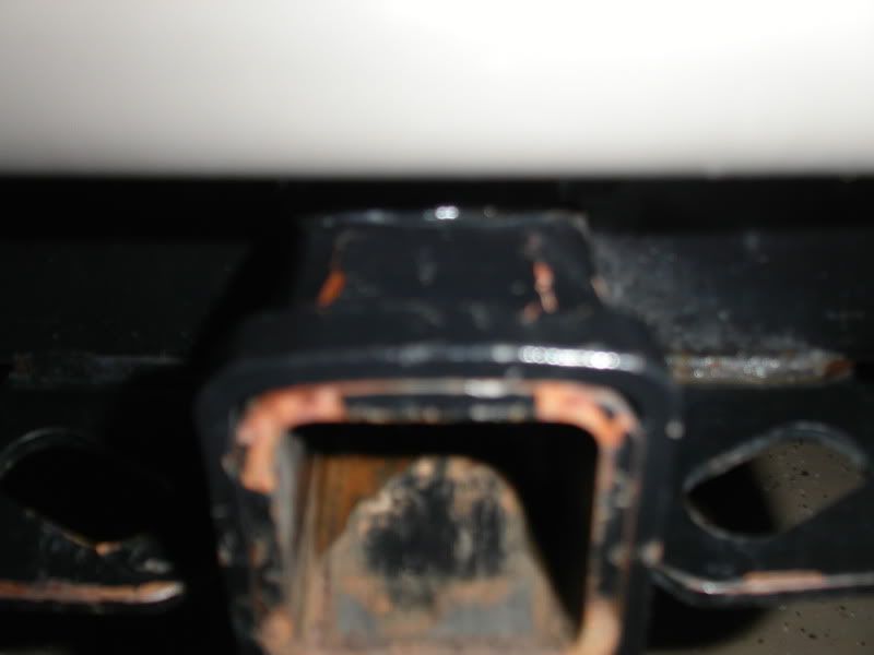

I got a good laugh out of that, but at the same time, I can't help but remember the issue we had with the hitch on the '05. The metal did start stretching and the paint cracked on top.
The best solution we could find was to find a local hitch place that custom fabricates hitches. Instead of replacing with the original, I had them weld in a 2.5" tube and add extra bracing in front and behind to strengthen it. If it cracks now, I don't want to know what was going on back there...
