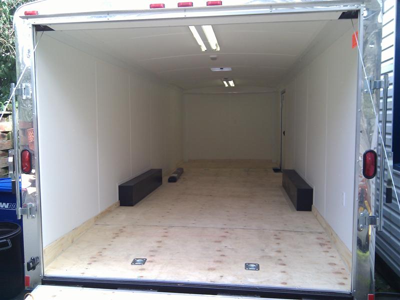

So I just picked up a new 24' enclosed trailer this past week to haul my road racing car around. Got a few options installed at the factory like 10k axles and finished interior but will add cabinets later on. Already have some e-track to install and will be working on floor finishes, tire storage, and other niceties ahead of racing season.
Anyway, I need to upgrade to a weight distributing hitch. I currently have stock suspension on my 2005 PSD but in the future may upgrade a bit. I'll be towing probably 8000 pounds around the Northwest, including windy mountain passes and such. Assuming 10% tongue weight that puts me right at 800lbs. Most of these hitches are for 800 lbs or 1200lbs, so it seems I would want to err on the side of safety and get a 1200lb model?
