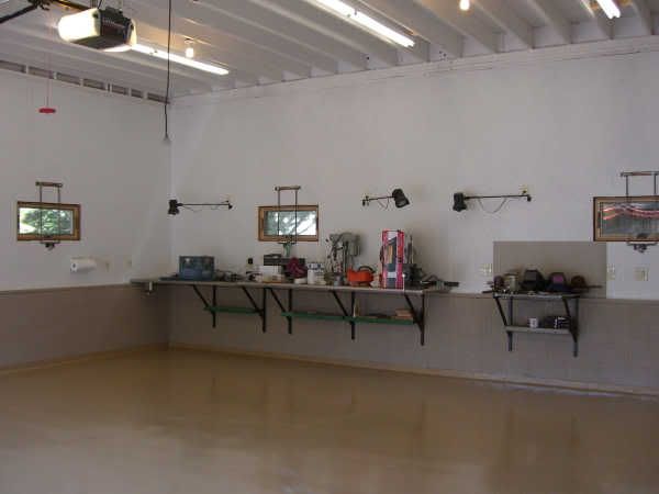

In my garage (28x28 with 12' ceilings) pictured here:
I used 14 4' two tube T-8s with reflectors mounted in 3 rows of 4 and 1 row of two. Staircase going upstairs in the reat corner shortened last row. They are mounted to 2x4s across the joists to put bulbs even with bottoms. I sprayed the ceiling and OSB covered walls with gloss white paint (latex on ceiling and industial epoxy on walls) and painted the floor with semigloss urethane industrial coating designed for airplane hanger floors in a light tan. Having light reflective surfaces increases the brightness dramatically.
I also have swivel and swing task lights made from surplus stage lighting fixtures with spot bulbs installed over each bench. I have a double set of 20A duplex outlets (4 outlets total) every 4' around the perimeter on two circuits (one duplex on each circuit at each location). I color coded the outlets using tan and white outlets to designate which circuit they are on.
IMHO you can never have too much light in a work space. I am still considering mount some more flour. fixtures on the side walls 7' from the floor pointed horizontally.

Nice shop Ax! i also have lights mounted 5ft from the ground and agled to the floor, makes a big difference!
