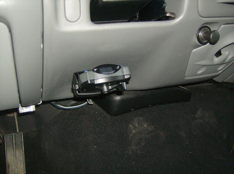

It can be mounted at any angle vertically in the direction of travel. Its more important that its parallel to the direction of travel +/- 20 deg and that the front of it should be horizontal +/- 20 deg. See:
http://www.tekonsha.com/content/down...ion/N90885.pdf
Here's mine and have had no problems what so ever.
Edit.... nice switches william_04_x!!

This is where I mounted mine. Just like 1975StroppeBaja.
