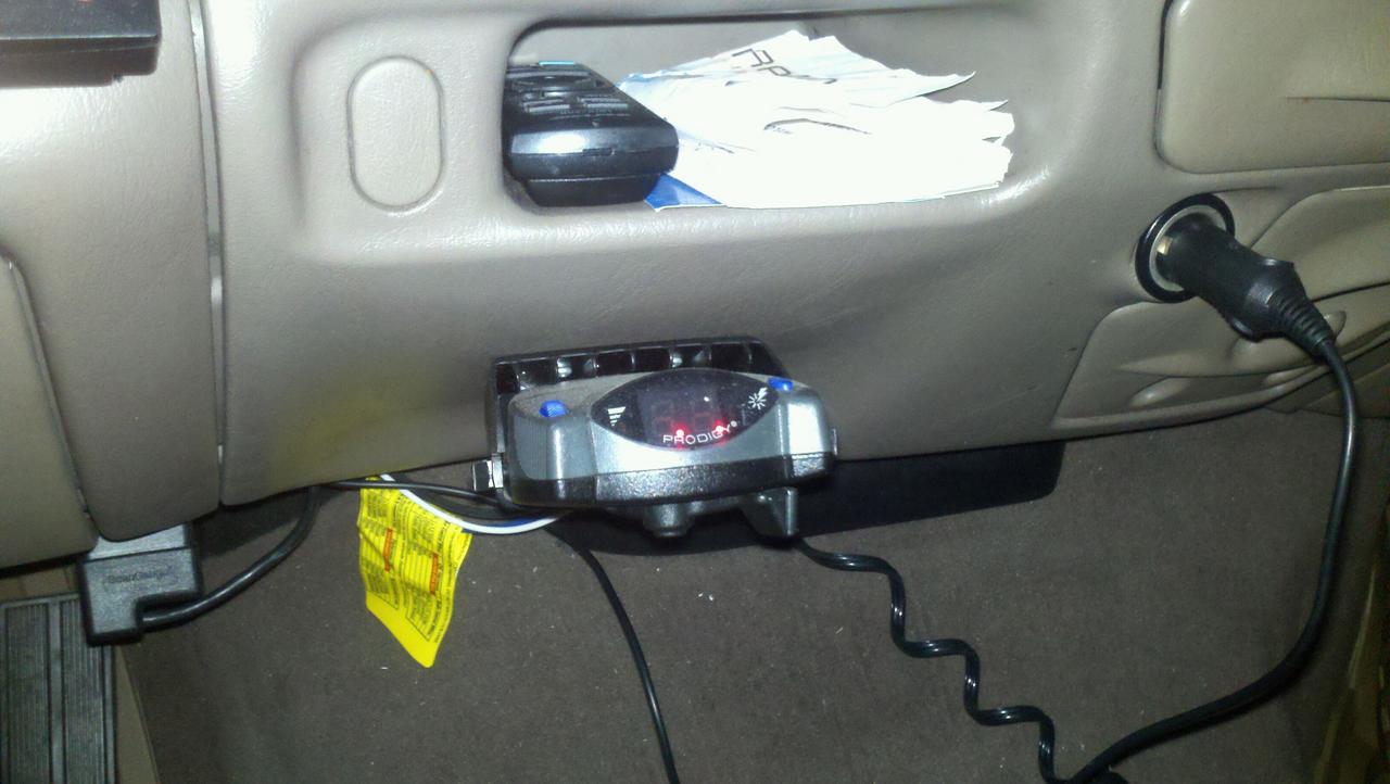

Originally Posted by william_04_x
Mine's also where snowseeker has his. 80K+ miles of towing and no problems.
I have my ScanGaugeII in the cubby.
I don't have a Prodigy, but I mounted my Hensley Tru-Control just like this and it works fine. I have a very similar back up camera installed as well.

I have mine in the same places as 1975StroppeBaja and jh818. That way I can still get to the manual brake override lever on the bottom of the unit in a pinch.

Originally Posted by 1975StroppeBaja
It can be mounted at any angle vertically in the direction of travel. Its more important that its parallel to the direction of travel +/- 20 deg and that the front of it should be horizontal +/- 20 deg. See:
http://www.tekonsha.com/content/down...ion/N90885.pdf
Here's mine and have had no problems what so ever.
Edit.... nice switches william_04_x!!
I think is where I will put mine. I looked at mounting it lower (and level) at the bottom of this trim piece but 2 things bothered me:
1 - it would be a long reach to hit the manual override brake lever if I needed to and,
2- the back of the unit would be in line with the heater duct which could lead to premature failure of the unit from excessive heat build up.
That is where I had my Tekonsha Voyager in my F250 and in my Excursion. It's easy to reach and make any adjustments. I used superglue to attach industrial velco to the dash and the brake controller. I didn't feel like drilling holes in a nice dash.

Sorry to sound like a broken record...My Prodigy has been mounted just like jh818's for nearly 6 years now...never had an issue and it works perfectly. I like that spot because it is out of the way, accessible end you can SEE it...which came in handy when my 7 pin plug came OUT when I left Ben and Jerry's after making a very tight turn...thankfully I noticed it flashing between .C. and NC and then went to the .. display which told me I was without trailer brakes!...thankfully I noticed that BEFORE getting back on the interstate!
The Prodigy is one of the best controllers out there and for the money...it is very hard to beat. Some want a hydraulic controller like the BrakeSmart...but for ease of installation and IMO excellent performance coupled with very affordable pricing...you can't go wrong...
Mount it either under or in the cubby and you will have no issues.

Originally Posted by jh818
I mounted mine in the area below the cubby hole pocket in the dash. It's on an angle, but it works ok.
That's where mine is mounted too. Works great.
This is where I mounted mine. Just like 1975StroppeBaja.
Attachment 33123
Excursion - Mine is just a bit further left so I could get the satellite radio receiver mounted next to it.
The Prodigy is very good. On our Pathfinder it is on its side and it still works. Not really sure why it works, but I cannot find any place to put it.
