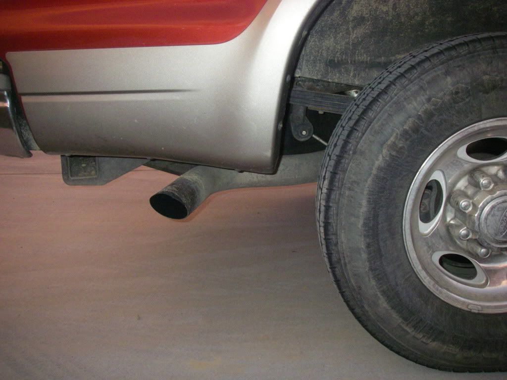

well......all went fine until I got to the tail pipe. The pipe would not fit, it hits not only the rear strut but also the tire. I think they put the wrong set of tail pipes in the kit. Has anyone else had this happen to them?

nope, tried everything, it just will not clear the rear. I think the bends are off. I do not know what I am going to do now, I cut the stock stuff off and can not re-weld it back. I also tore a orange circular pyramid looking piece from the rear suspension, any one know what that is for?

Wow I got the pipe in, I had to drop the rear shock to get it in the right position. Pics are forth coming.

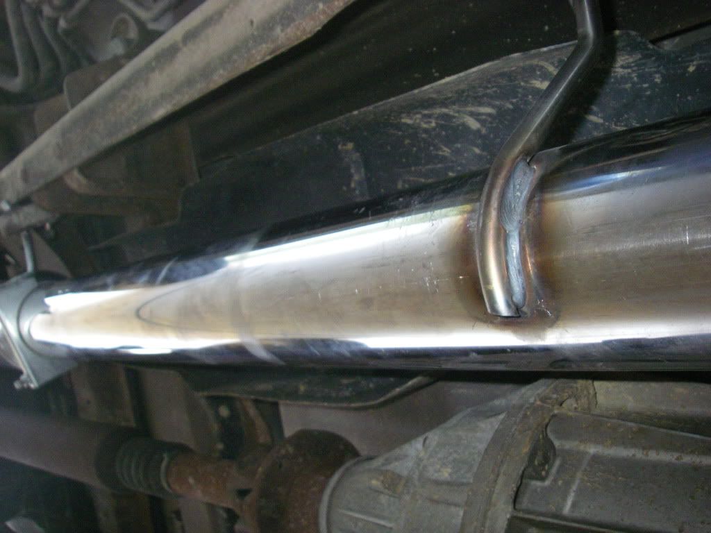

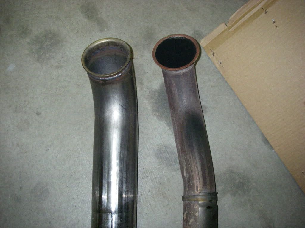

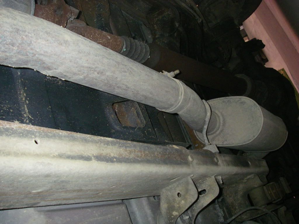

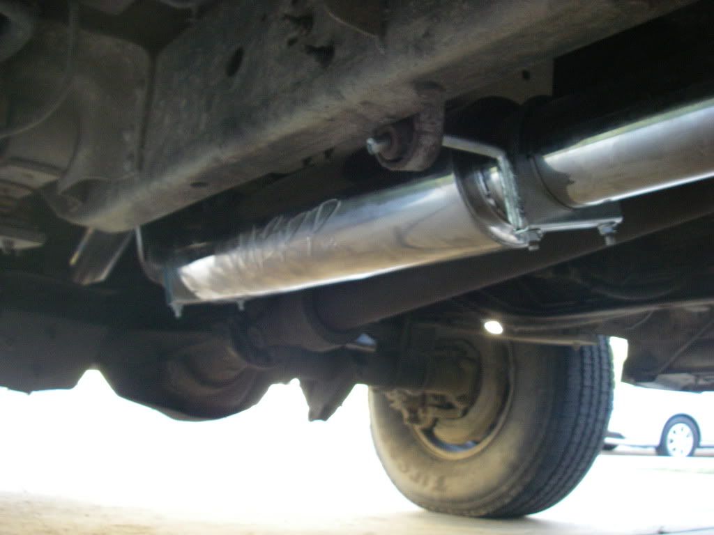

Here is the down pipe
Here is the stock transition and muffler

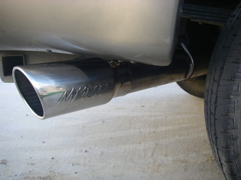

Here is MBRP Transition pipe and Muffler
The tail pipes
