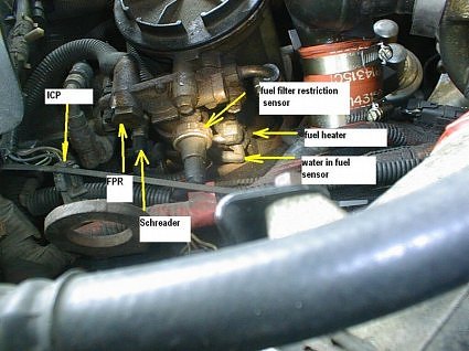

Look at Fuse 22 under the hood first .....
If it is bad , unplug the fuel heater
Name:  Fuel heater connection.jpg

Thanks Action4478 just checked fuse 22, its fried will be taken care of that.

I just started it and went back on the house to let it warm up at idle. I just checked fuse 22 and its fried will be fixing in the A.M.

Unplug the fuel bowl heater or it will pop the fuse again most likely.

The fuel bowl heater corrodes and shorts out. It's tied to the same circuit as the PCM so when it shorts out, it pops the fuse for that circuit cutting power to the PCM.

Its a fairly simple swap... remove the fuel bowl lid, remove the stand pipe (LEFT HAND THREAD) and pull the heater out and replace it, but it's not super necessary. Many people just unplug it and forget about it.

Mine actually leaked fuel on to the wires that are connected to the fuel heater and fried the fuse so mine was just the O-ring.

Unless you are in the arctic , you won't need it .. If you want a new one they are kind of spendy .. some have replaced theirs with the 99 up version .. about 30 .00
