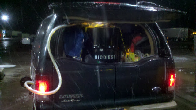

"almost" made it from Bucks County PA to Dickinson TX on my own fuel. 12v compressor didn't work very fast so I ended up backing up to an airline to finish transferring fuel.
It was a PITA to refill the drum though, had to do it in the truck because even if I was able to fabricate a lower valve assembly it would have been tough to maneuver a 500 lb drum into the back. With the valve assembly in place I had to lean the drum forward and stand it up once it cleared the lower part of the headliner by the back hatch.
Very rewarding to drive 1500 miles with my own fuel.

couldn't smell anything, both bungs were sealed up good with yellow tape and I had a valve on the hose, the air chuck fitting didn't need a valve. Besides biodiesel smells nowhere near as bad as petroleum even if there had been a little seepage from around the fittings.....
the drum was free and the fittings cost around $30. Oh and the straps cost $18. Far cry from $1K plus installation

Sweet! Did you consider mounting the drum on it's side so you can fit it in and out easier? Also, then you could tilt it slightly to one side to get it to drain better. A few well placed brackets would keep it from rolling around.
I like the idea. Very nice.
I was afraid that the bung connections would leak and didn't want a mess on my hands.
Also the hose was only to refill the tank and I just opened the rear hatch as you can see.
The mistake I made when I got home was putting the last 15-20 gallons of biodiesel I bought in Houston into my tank. Now I have to go rent a propane heater and put a tarp over my truck to get it running again. I figure I'm at about B75 right now- this would have never happened with the fuel we make, apparently the feedstock for this fuel was not clear veg oil although it looks like very nice fuel.
