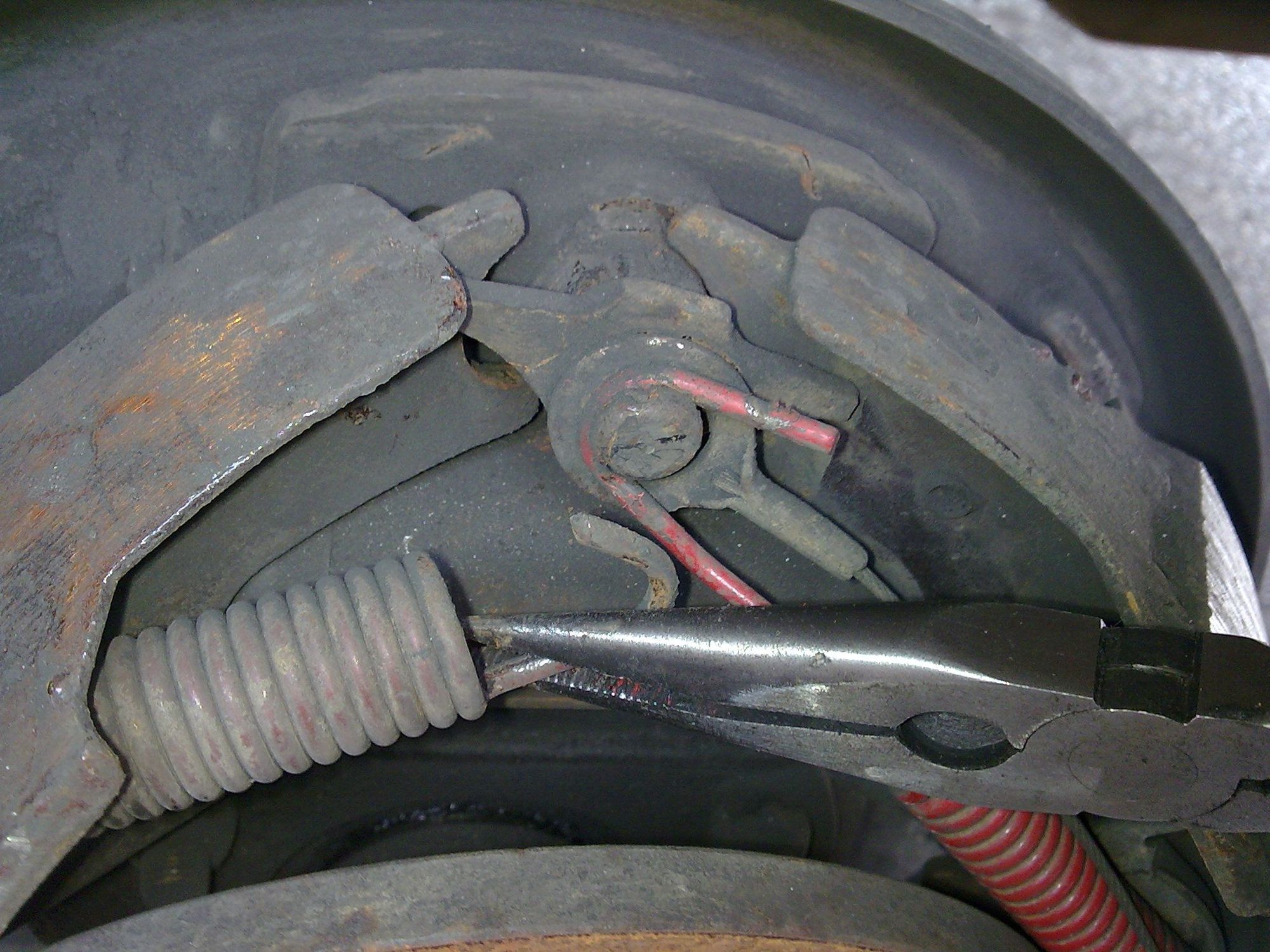

To get the brake shoes out I used the pliers like shown. Without grabbing the nail, push the spring back and use your other hand on the back, in the nail's head to rotate it until its aligned with the washer's slot and releases both the washer and the spring. Do this on both shoes and save every washer, spring and nail.

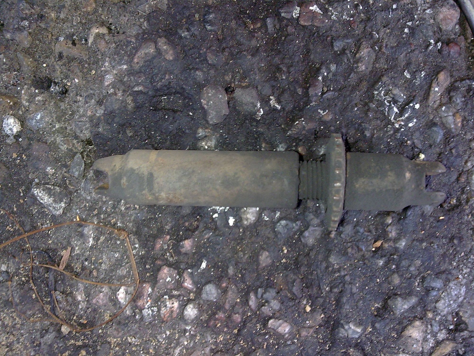

Now with a little more freedom of movement you should be able to take the auto adjuster out. If you plan to reuse it remember to clean/lube it.
