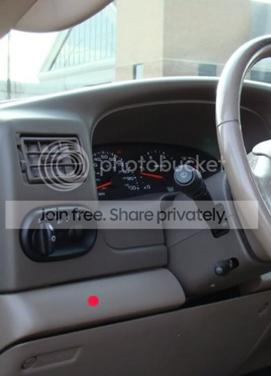

I have had several people ask me where I installed my alarm light to maximize it's effectiveness. In this image, I installed the flashing light where the red dot is. By placing it here, it's highly visible to anybody standing outside the Excursion contemplating breaking the glass or cracking the door handle to break in.
Most amatuer criminals will move along rather than risk getting caught when an alarm goes off.
Hope this helps.

X2 since I one of the people who have asked. Yeah, still looking at which wires to splice into for the always hot, key hot, and ground. Not sure how I want to do it yet.

I wired mine to the radio wires today so it wouldn't cut on till I opened the door when everything turns off.

Pics or wire colors?

Yellow wire from light to red radio wire, red wire from light to yellow battery wire to radio then black to black ground
