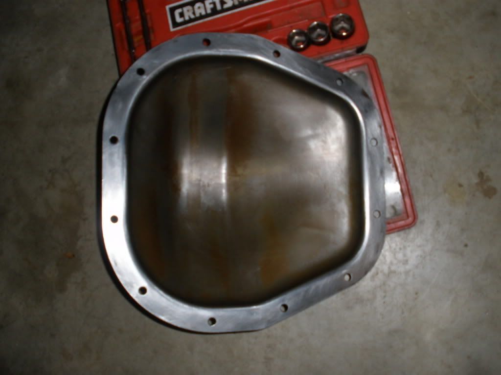

The inside of the cover had some grime on it. Nothing a little rubbing with a towel can't take care of.

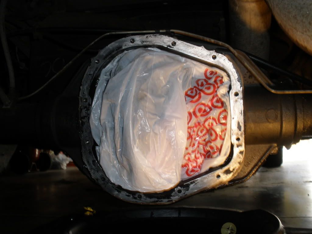

Using sandpaper I was able to remove all of the existing sealant from both the cover and the axle. I used a rough grit to remove the large pieces, then a fine grit to remove any deep scratches left by the rough grit paper, and lastly I used steel wool to smooth everything out. Make sure to cover the diff with a plastic bag to make sure the pieces of sealant being removed don't get into the gears and crevices.
This is the results I got after some sanding and cleaning. Be sure to remove all traces of old sealant to ensure you get a good bond with the new sealant. Also, I used a good cleaner on all mating surfaces to make sure no grease or oil was on the surface.
