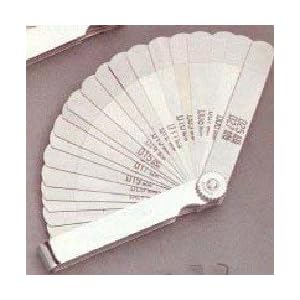

You may find it easier to check with a go-no go feeler gauge. They have a stepped blade where the one you'd use to check for .019 would read .018-.020. It would fit loosely at first then go no further if adjusted correctly. It would take a matter of seconds to run down the row of valves using that method, and adjust the ones you need to accordingly.

^I might need a new feeler gauge, if so, I'll get the go-no-go one. I just don't think it's absolutely needed.

A USED engine (223 6cy) rocker lash .019" when set to these specs will actually be looser than .019" due to the fact that the valve stem has worn itself into the rocker and when checking with feeler blades they are wider than the valve stem wear spot.
I have (somewhere) a service bulletin from ford showing the use of the PG Gapper tool
Basically you follow the manual instructions and this tool is like a dial indicator to view the TOTAL lash including wear spots.
I know clear as mud but just trying to save you some head aches because you'll do it by the book with feeler blades and in reality they will be looser and still making noise.
