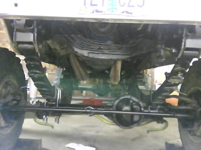

this is my homedone cross over steering setup
i have a solid day of labor into it, little bit of custom fab to fit the steering box and doing all the measuring to make sure alignment was done. I have the cost of power steering fluid, 1 new high pressure hose, some clamps.

Thanks Bendog, and the rest of the guys showing their crossover steering kits it helps to see how some ppl have done theirs my truck is 3/4 ton with leaf springs here is a few pics i am still in mid process of finishing the lift i still need to order custom u bolts for the front but the kit i was looking at has it mounted on top of the knuckle to help it clear the spring pack and such... but here is pic and i welcome all oppions.. and i dont want to drive my truck off a cliff bendog haha
