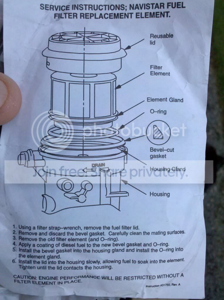

The key is to put the beveled o-ring on correctly. It is easy to confuse the wrong way with the right way if you put the o-ring on the cap versus sitting it on the fuel bowl flange.
