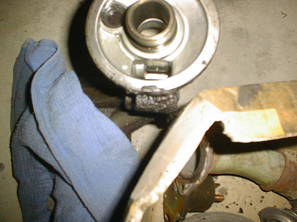

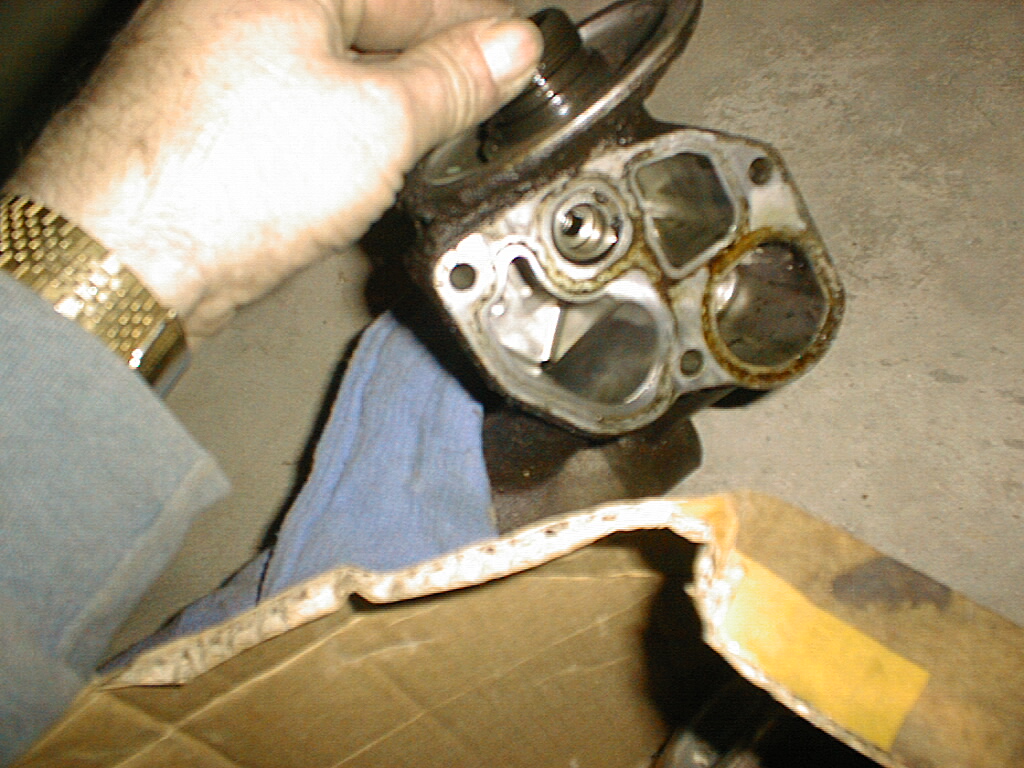

Valve Pics ...
There are 2 valves , only one under oil filter , the other is only accessible hen the manifold is removed from the motor

Thanks again Rick. I wish I was a little more smart with this da$% computer, I'd have some more of that stuff to pass on..
Rt Click On the Pic, save image as , & put it in your photos(pictures) file

Thanks again Rick. It worked.
