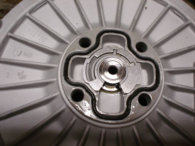

I have posted the pics in an album named Scary Find on here but I can not seem to figure out how to post them in this thread?!
I think this would be the link to where i have put the pics:
https://www.ford-trucks.com/forums/m...cary+find.html

Turbo thrust bearing?
I think it's time for a new turbo.

I dont think you can post if you are not a supporter or have a certain number of posts. I'll add them for you.

The holes make it look like a thrust bearing, but the thickness throws me off a bit. I'd pull the intake off and see how the turbo feels before I even started the truck any more.
This is a thrust bearing
I'm not positive if it would be possible for that piece to make it out if it did break?
Edit, after looking some more I would say Clux has nailed it, it is looking like a thrust bearing.

Here's the pics for easier viewing
