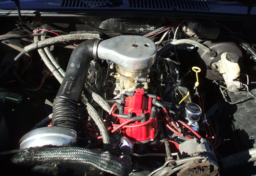

Originally Posted by V8Ranger302
5.0 fits nice.... lol.... But like everyone said, I bit more complicated, not hard though.... Mine still has the stock 2.9L motor mounts.
Attachment 229143
what makes it more difficult
