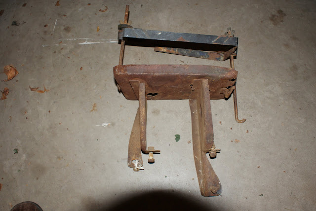

Your right, the one on Ebay definitely is not original for 48-50. And as 51PanelMan mentioned, the support brackets under the tray for the 226 Six are shorter than for the V8. Below is a picture of the one off of my truck. It appears to be in better shape than it actually is. The the welds holding the right bracket to the tray are broken and the tray is rusted through where that bracket attaches. Merc52 has one in better shape that I'm thinking of buying.

All you really need is just a good tray. You can remove your rusted through tray and replace it with a better tray. However, most trays rust out. If you can't find a complete assembly for your application, then I would just find a decent tray for the V8 and swap them out.

That'll just buff right out!
