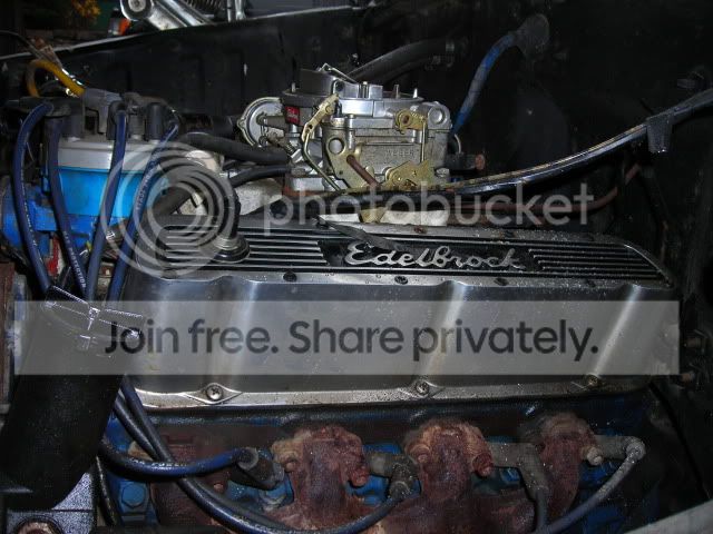

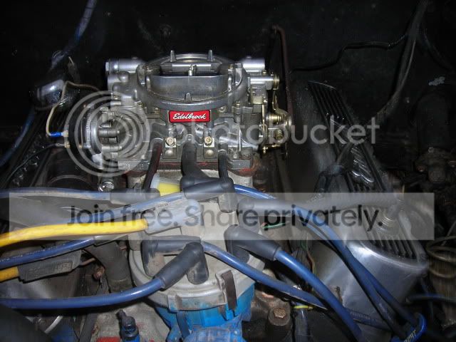

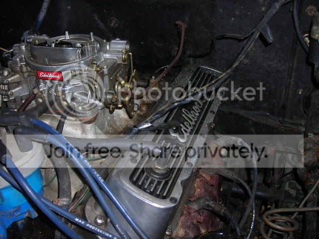

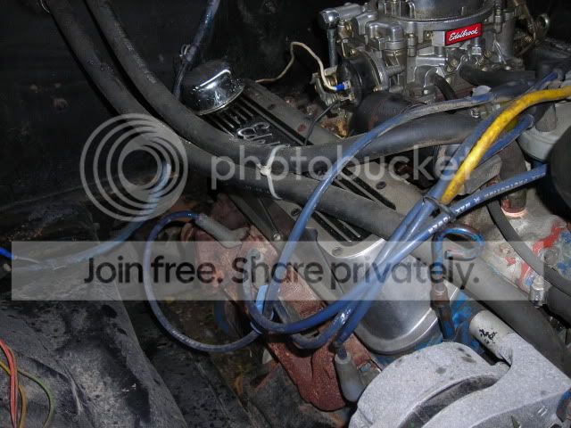

Got some pictures of the engine. There are 5 bolts on each valve cover.

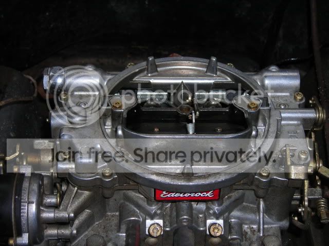

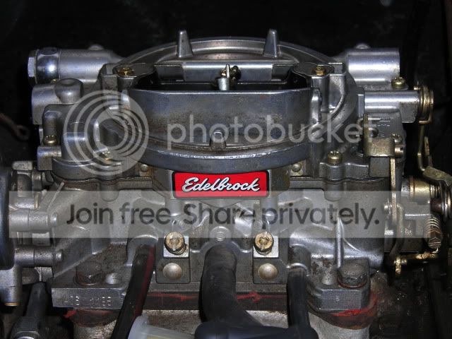

Also, here is the carb that I have on it. I was told it was an Edlbrock 650, can anyone confirm?

That is an Edelbrock 600 cfm 1406 with electric choke.
Looks like they installed the carb with RTV as well? That could cause massive vacuum leaks.

So re-gasket it at least and see what that does? Any idea which year 302 I've got?

Looks like the P O really liked RTV ,it'l clean up though.

I thought 289's had 6 valve cover bolts. I couldn't see clearly, but I saw 3 along the bottom and 1 at the top left corner. There isn't one in the middle and then on top back corner?

I only counted 5. 3 on the bottom and 2 on the top in each corner. There wasnt one in the middle. The valve cover is an aftermaker Edelbrock, maybe there is a hold in the top middle that isnt being used? I dont know. I only counted 5 bolts and the Stamped code I got off the block fits for a 289.

5 valve cover bolt holes per side = FE engine.
6 valve cover bolt holes per side: 221/260/289/302/351W.
How do you know the C5AE-6015-E block casting number is for a 289? It could be for a 260 or a 352/390.
Casting numbers cannot be cross referenced to Ford part numbers, are usually worthless for ID'ing engine sizes or what it's from.
