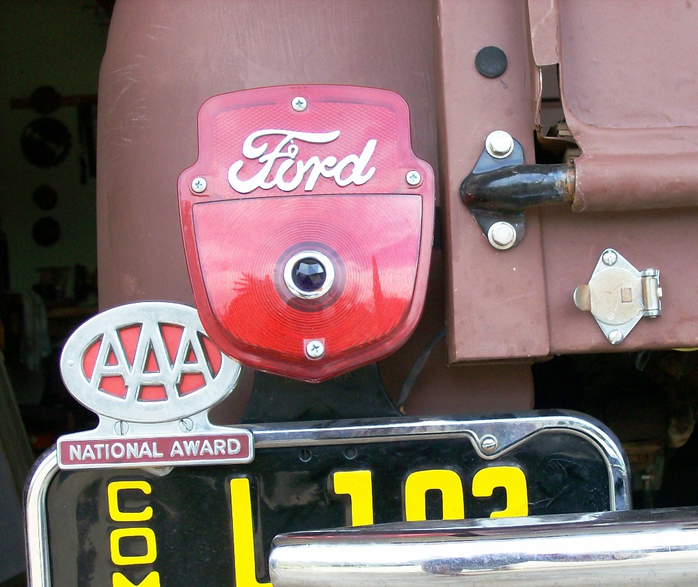

The mounting brackets (slanting DOWN) bolt onto the back of the stake pocket using the tailgate hinge pin bolts.
On many of the trucks there is a third hole higher up that is the same distance up from the second hole as the second is from the first. Using the two higher holes makes the lights more visible. But if you mount your brackets slanting up or use the upper two holes instead of the lower two, you run the risk of having your license plate interfere with the bottom edge of the bed - if you hang it with an OEM style license plate bracket on the tail light bracket as well.
Up from the bottom edge of the stake pocket the three holes are (on center) 2 3/4;" 4 3/4;" and, 6 3/4."

Thats it! just what I needed. Thanks so much. I'm sure I will have many more questions in my quest to make this think look nice.
