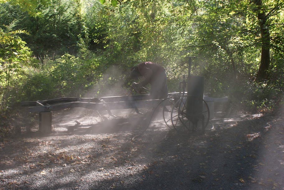

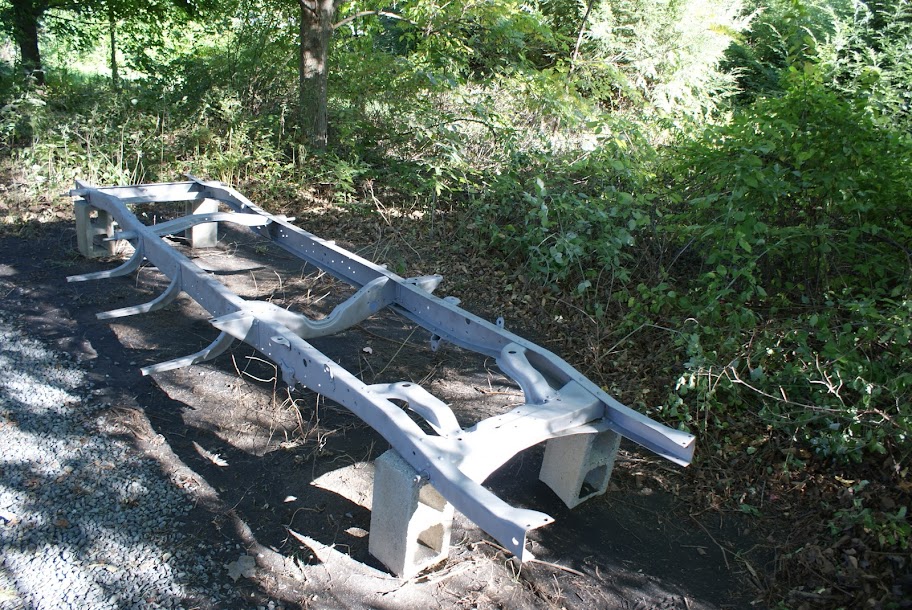

Sunday in New England was a perfect day for sandblasting so I called a guy I know with a portable unit and he came over and did the whole frame for me.
I hope to have it painted by the end of the week. Starting to feel like I'm making some progress.

Looks great... What are you going to do with it? What color is the paint for the frame?

Don't let it sit too long or you'll get flash rust and have to clean it up again.

IMO, there is never a good day to blast but you did something I couldn't, have some one else do it. Blasting is only out ranked as the worst job by doing fiberglass work. I know, I've done a lot of both.
Frame does look good. If you're interested I painted the frame on my '37 Buick, the car I blasted a few weeks ago, with a PPG epoxy mastic paint, it's a direct to rusty metal paint used on outdoor structures like water towers and bridges. It's a lot like POR-15 but a lot cheaper.

what kind of sand did you use? and how did you collect it? I've been considering setting up a lil outdoor booth myself on the side of the house. I love the look of clean virgin metal!

I used regular sand, I know, I know, silicosis. I did it out behind the silo on the farm with respiratory protection. I had to blast twice this year. The first time I blasted the first body and frame and found they were in pretty rough condition but then I got a very good offer for another body and frame but still had to blast that one.
The first time I blasted I collected the sand in a nylon tarp laid under my rotisserie. I blasted a couple of pots then rolled the car off, pulled the corners of the tarp up to get a pile of sand in the middle, then sifted it back into a couple of five gallon pales and then rolled the car back and did it over again. A real PIA. The second time I just left the sand lay using fresh dry sand in each pot.
Most people don't have the luxury of being able to have an open place to blast. I would strongly suggest not to blast anywhere near the house. If you do I will guarantee you will have sand in the house no matter how well you try to seal the booth. You'll be finding sand six months later. Also, I mentioned silicosis about, do a Google search, it's a nasty affliction. If you read the government reports it says it affects people with long term exposure to sand dust, which contains silica. I know it's dangerous but I only blasted for a couple of days out in the open air with a good breeze so I wasn't too concerned about it. I would be concerned though with having a booth attached to the house. Like when painting, the person doing the job should have proper respiratory protection but the people in the house won't and there is a good change of fumes and dust penetrating the house and exposing the people within. Blasting and painting should not be done near the house.

We didn't actually use sand. It was a product called Patriot Blast - Slag Abrasive Product. Since the frame wasn't in that bad shape to begin with, we used the fine grit - 4 bags did the job at around $12 per bag.
Regarding safety, the bag contains the following label:
Health Hazard - 0
Specific hazard - 0
Fire Hazard - 0
Reactivity - 0
"Contains 99-100% coal slag. Treat as nuisance dust. Typical free silica is less than 0.1%. This material is not a recognized as carcinogen or cocarcinogen. Mechanical irritation may occur if proper protective equipment is not used."
We didn't try to collect it. Most of it blew away as dust and what was left will be covered by weeds as soon as it gets warm in the spring. I was really surprised how little of it was laying around when we were done. I'm lucky that I have about 2 acres and the building where I work on the truck is far enough away from the house and the neighbors that it wasn't a problem. At least I haven't heard from any of the neighbors yet.
