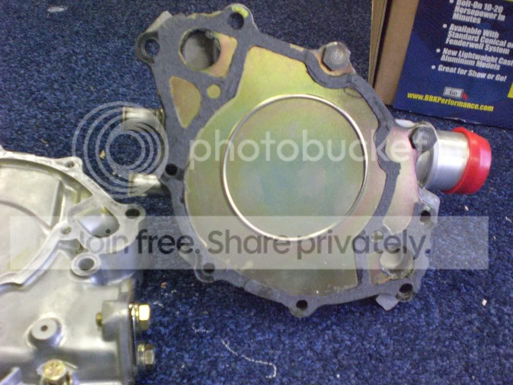

I just went through all of this and found the solution.
On 5.0 and 5.8 motors using a mechanical fuel pump the water passages on the timing cover are made for standard rotation waterpumps. The later model engines with fuel injection in cars and trucks have water passages on the timing cover for reverse rotation.
The early 5.0's with serpentine and mechanical fuel pumps did run a standard rotation pump, but the water pump turned reverse. This could cause cavitation at higher highway speeds.
If you look up the waterpump for a 79 mustang 5.0 the casing is identical to the waterpump casing up to 95 ford F-150. The 79 will be forward rotation and the 95 will be reverse rotation. Get the 95 waterpump. Look at the plate on the back of the pump. Instead of it having oblong holes on each end, it will have a circle on each end. This waterpump will work correctly with the proper flow and no cavitation on the early model motors with a mechanical fuel pump.
The circles are the only areas that match up to the openings on either timing cover. That pump has been made universal.
The pulley on the above picture is designed for the smooth side of the belt to ride on. The way it is in the picture is incorrect and may walk off the pulley. By going with the pump that has the circles you can run the belt correctly with reverse rotation on the pump.

Does the waterpump look like the one in the above picture that blown posted?
Here is a link that I posted when I was going through this confusion.
https://www.ford-trucks.com/forums/9...ce-please.html

This is a picture I pulled from an image search. This is what I am told the replacement water pumps look like for the 83 to 95 models. Looking at the part stores web pictures they do not look this way. The best thing to do is go to one and check them. Maybe print this picture to compare. note the circles for the water passage.

I am using the timing cover from a 1975 granada. This is what the original water pump looked like.
This is the pump I am using now. It is on the same 1975 timing cover.

The bottom pic is the same as the pump i currently have I didnt realize they would both work. What is the bottom pump off of again?

A 79 mustang looks just like that bottom picture, but is forward rotation.
A 89 to 95 F-150, 250, 350 or the nineties mustangs look exactly the same, but with reverse rotation.
Check your parts stores and physically look at the pump to see if the back plate has the two circles on the back and not the two oblong holes.
