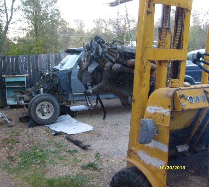

Well, today I finally was able to begin the disassembly of my mutt truck so I can install the stuff in my truck IN my truck and make it even more of a mutt with the 7.3 and the ZF.
Wish me luck, lack of free time, crappy back, and bad weather right around the corner may add up to this truck being down for a bit.
