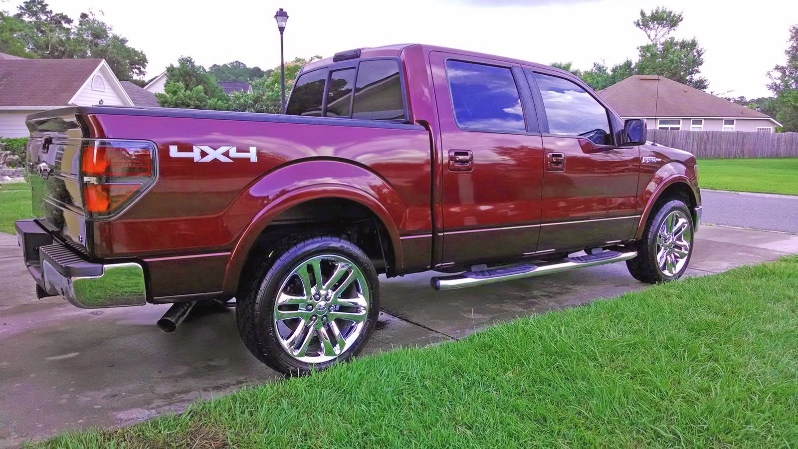

Find your Ford truck paint color
You can find your Ford truck paint color in the owner's manual or on the informational plate on the driver's side door jamb. Most auto parts stores will carry all Ford colors; alternatively, you can order them online. If it is a small scratch, a paint pen may be your best and least expensive option.
Find a location to perform the repair
Verify that you will be performing the repair at a minimum temperature of 50 degrees; the preferred repair conditions are above 70 degrees.
