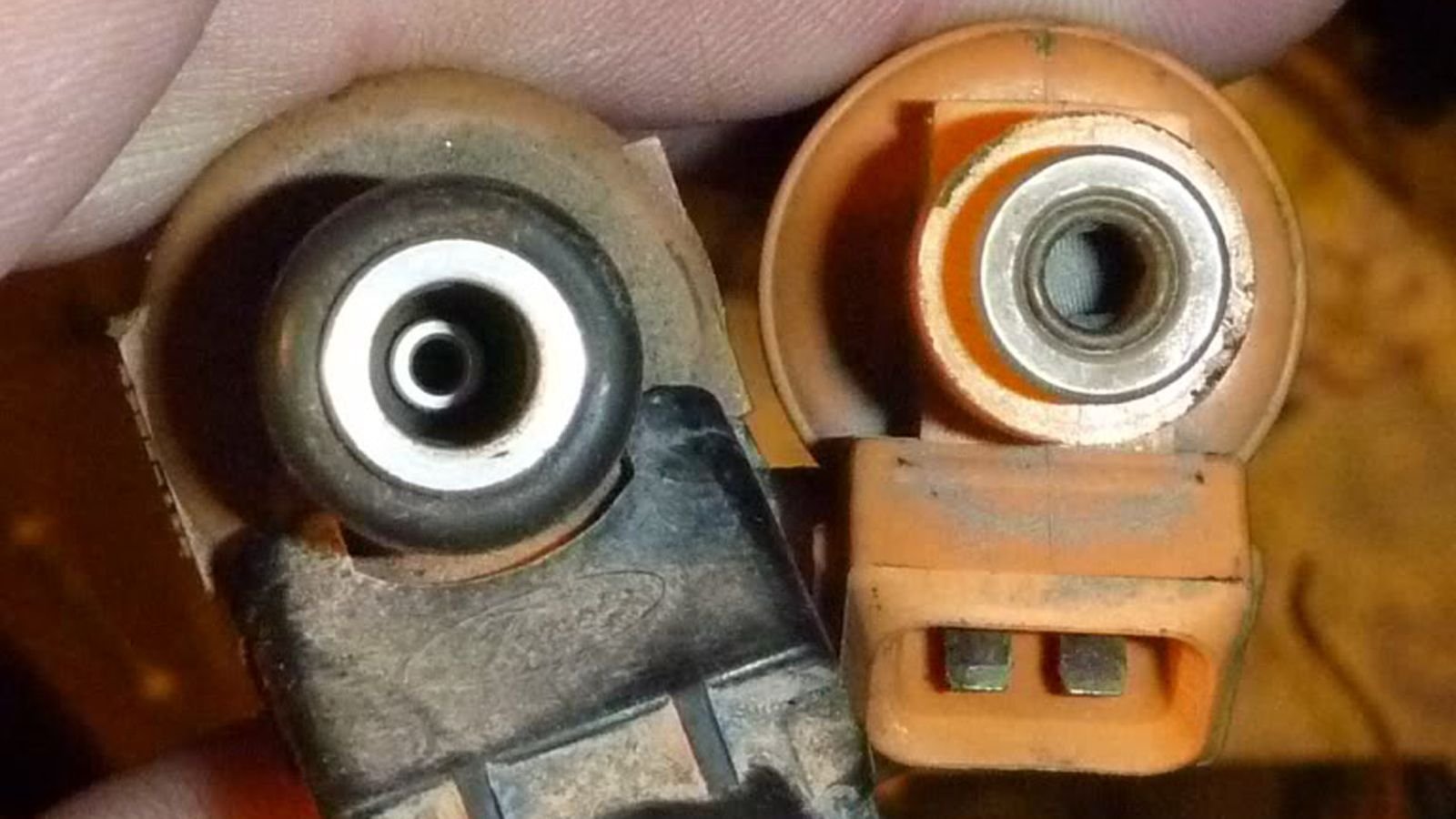

2. The Fuel Injectors are Dirty or Clogged
If the fuel injectors in your Ford truck are dirty or entirely clogged, this issue will affect the performance of the engine. If the shaking is intense, then a clogged fuel injector is likely to blame. Before checking their condition, you'll need to depressurize the fuel system and disconnect the battery. Refer to Step 2 of our helpful guide to diagnose and remove the fuel injectors.
