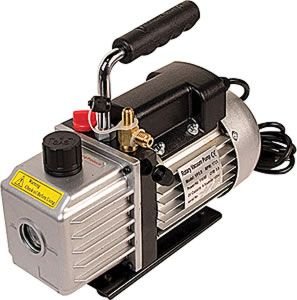

  • Once the engine starts idling, apply vacuum with a vacuum pump.
Figure 6. Use a vacuum pump.
  • As you apply vacuum, the engine should idle roughly. It may even stall.

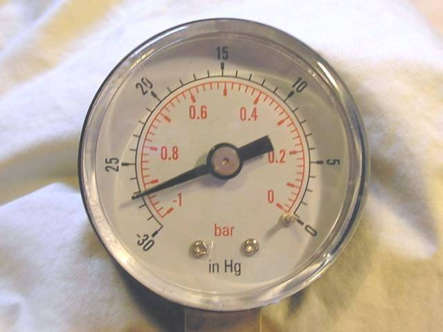

  • Apply vacuum again, and hold the vacuum for 20 seconds.
  • The vacuum pump gauge's needle should stay steady.
Figure 7. Watch the needle.
  • If the needle doesn’t stay steady, check that the vacuum hose is connecting the vacuum pump to the EGR valve and is making a tight connection on both the EGR valve and vacuum pump.
Figure 8. EGR valve.
If the engine idle grew worse when you applied vacuum with the vacuum pump, and the vacuum pump’s gauge needle stayed steady, then this result indicates that your EGR valve is working properly.
